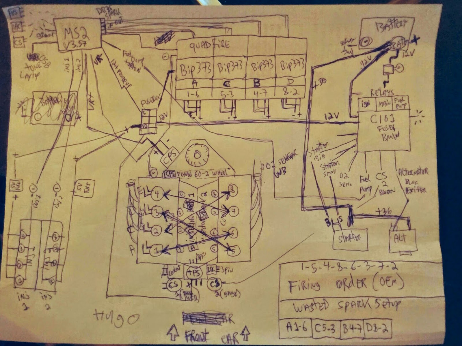

              I have ordered all the stuff I need to run my own EFI system...I even manage to find information on all the OEM sensors I will run with my new Engine management.
              Drew up a quick draft schema of what it will look like (approved and signed by my 5 year old son hugo LOLLL)... of course this is high level but I will draw sections in details after as I go.

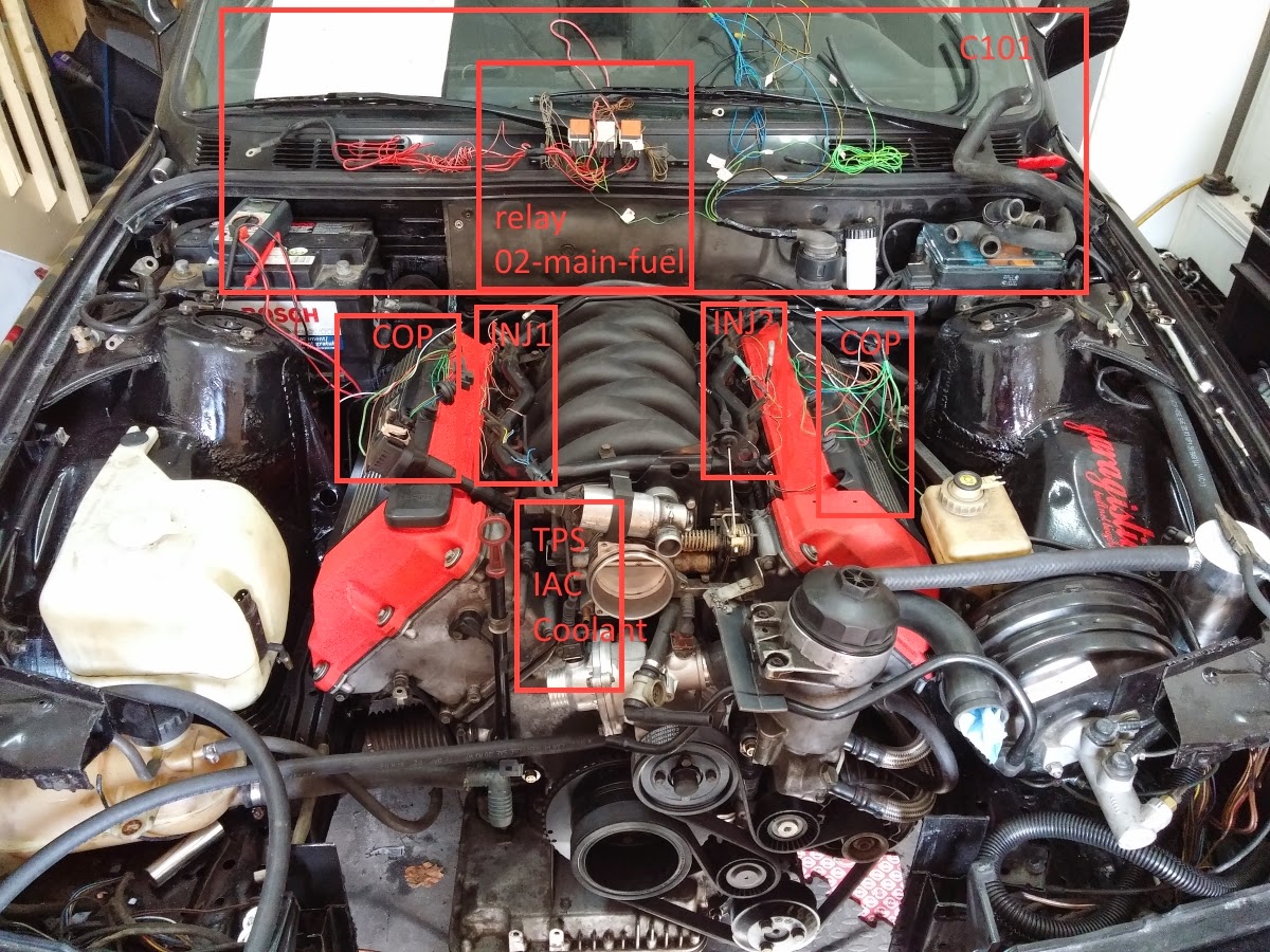

                    Getting wiring prepared for MS2 which I should have on March 28 :)
                    Cant wait to fire this beast...my timeline is to get it started by end of March...

                      Hi Denny, I don't see an IAT sensor plan, does MS2 not have this?
                          yeap for sure can never have enough safety..its not on my chart yet but I plan on running it in that nice location right after the TB (hope it just screws right in the place with same thread) Im going to use the GM one.

                          I suspect your Drivers are running HOT.. What setup do you have to them? are you using a good Heatsink? Location? Im going to use the QuadSpark from Diy (nice heatsink box made just for them I can hide away from the heat)
                          How did you wire the COPS in Wasted spark mode? Green(Power)- Brown (Ground) - signal (???).
                          Denny

                            Hi Denny,
                            I am using the GM IAT sensor as well, I just mounted it into the intake tube, that's where it is stock on the M62. I'm not sure where it would go after the TB, but go for it if there is a place, you want it right in the path of incoming air. I don't think it's for safety, as far as I know, megasquirt uses this to calculate the air density and thus the fueling rates.
                            I'm using the same coil drivers as you, quad spark, I have two of them mounted inside the cabin on the firewall. They are wired for sequential in my set-up, but set to run in wasted spark in the MS3, it works. I also used the stock harness after the quad spark, it's shielded.
                            Anyways, my theory is that the COP's are causing the misfire because they are running in wasted spark. That's why I'm interested in how yours ends up working. I need to get my cam sensor working which would rule out that theory. I'm still a bit sick of troubleshooting signals to the MS3 after a bunch of problems with the crank VR sensor initially, so I've put it off.

                                #90
                                Hi Denny, I don't think that wiring is right for the stock COPs. I'm sure it's not actually. They are three wire coils, they need constant ground and power(green and brown), the other colored wires on each coil are the trigger that should be wired to your quad spark.
