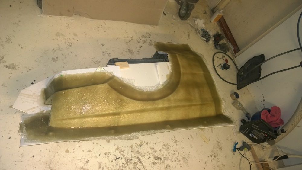

              Fiberglass fenders, cool!
              No, just molds for carbon fenders
              • jannmann
                • Jun 2014
                • 41
                #52
                carbon DIY
                • jannmann
                  • Jun 2014
                  • 41
                  #53
                  more..
                  1,1kg before cutting. 945g after cutting. of course i have to glue one part to it, but i gues it still weighted under 1,1kg after its ready.

                            Originally posted by squidmaster
                            Nice work! Love the vacuum molding for the cf and fiberglass (or was fiberglass just for the mold?)
                            I would love that engine
                            All parts are made from carbon.
                            Of course there are differend kind of cores inside.
                            I only use fiberglass for molds.
                            Now i'm start building owen for carbon.
                            I move from wet+vacuum / injection to prepreg carbon.
                            Then i can do much lighter parts.
                            Lightest bonnet was now 2,9kg.
                            With prepreg i think that can be aprox. 2kg. And still have enough stiffnes.
                            Door i calc that maybe weight also aprox 2kg.
                            Cant wait to get my owen ready.
                              If you are willing to do it, PLEASE post up some details of how you build your oven!!
                              Question, no vacuum is needed with prepreg while it is curing in the oven, is it?
                              • jannmann
                                • Jun 2014
                                • 41
                                #60
                                You need vacuun also in oven.
                                I promised to post pics when i start building oven.
                                Now I'm lookin good controller for temp rising.
                                With prepreg you can use nomex honeycomp for core.
                                That is the key for ultimate lightness.
