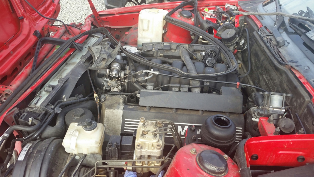

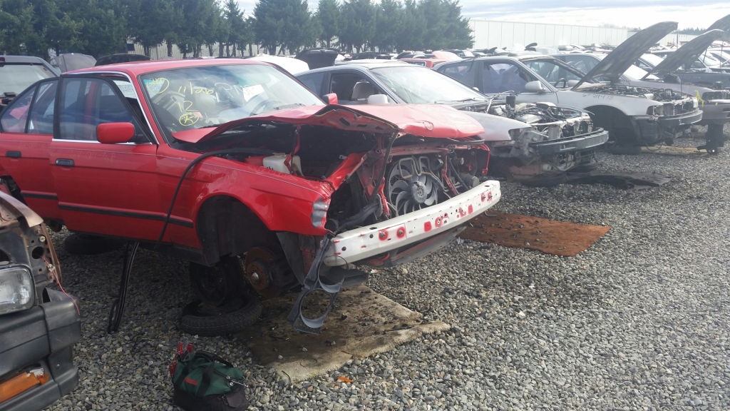

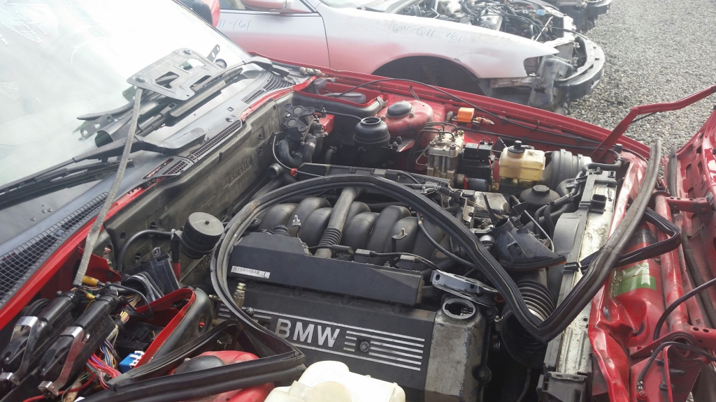

    One day, while looking for something else at a junk yard I found this:
    Anyways, I got a screaming deal, Only paid $180 after I took in a blown M20 for a core, that pretty much locked in what swap I was going to do. After about 2 hours, my partner in crime, Maston, and I got the motor out, and separated it from it's autotragic prison. We were able to get the engine, harness, alternator, PS pump, Exhaust manifolds....pretty much everything except the ECU, which was already gone. This lead to a few problems, One is I don't know what the mileage is, and I was not able to do a compression test, or leakdown. But at the price, I decided to take the gamble.

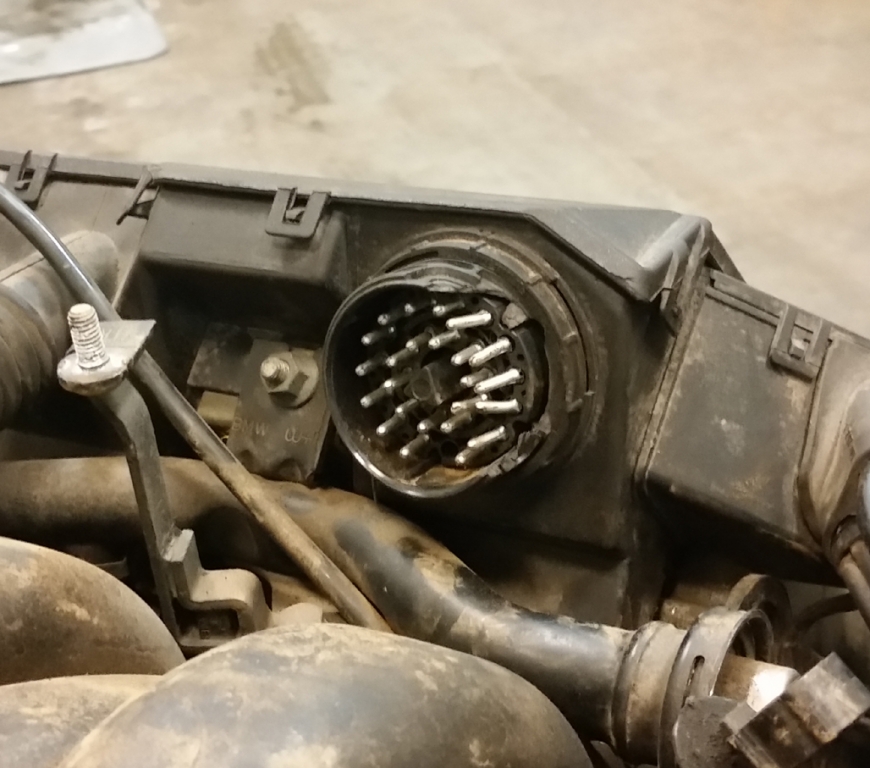

    Once I got it on the engine stand at home, I was able to do a little more evaluation. I got the down pipes seperated from the manifolds, and stored away until I need them. I also found a little damage from the removal process:
    So needless to say, I have to replace that plug. Also, the MAF is shot, I have the sensor, but the housing was completely shattered. other than that, I have not found any other damage. I was able to crank over the engine by hand, and it feels like it has good compression.

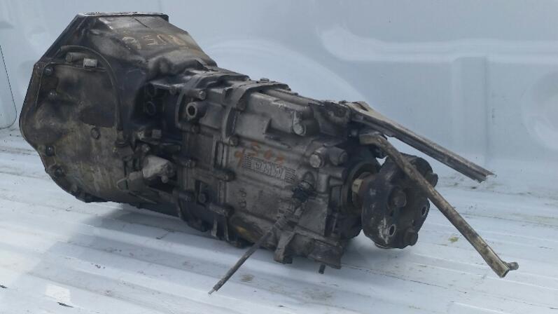

            Update, Scored a Getreg 420g out of a 2000 540i, I go pick it up on monday. Still need a Flywheel, clutch and 404 ECU at this point, and of course all the garagistic goodies to bolt it in. Pictures on monday.

                      Picked up the 420g today...
                      Also scored a 404 ecu for about $30 shipped. Will be here in a few days
