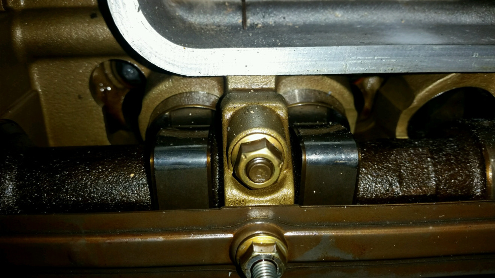

                  Picked up the 420g today...

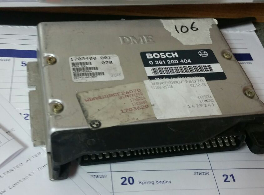

                  Also scored a 404 ecu for about $30 shipped. Will be here in a few days

                        Does the 404 DME require an OBDI conversion?
                        • delamaize
                          • Nov 2013
                          • 1463
                          From what I understand, the 0261200404 is OBD1. Unless I am completely off base.
                          Dumpster Fire Pilot
                          • delamaize
                            • Nov 2013
                            • 1463
                            DME showed up today, it has one of those orange BMW Service action stickers on it, not sure if thats a good thing or not, guess we will find out later....
                            Dumpster Fire Pilot
                            • straight6pwr
                              • Sep 2004
                              • 3450
                              from my research the orange dealer sticker was a service bulletin software update that they did to cars that were brought in for service, much like a recall. i've had 4 e34 404 dmes in my hands and two had the sticker and two did not. shouldnt make a difference, either way.
