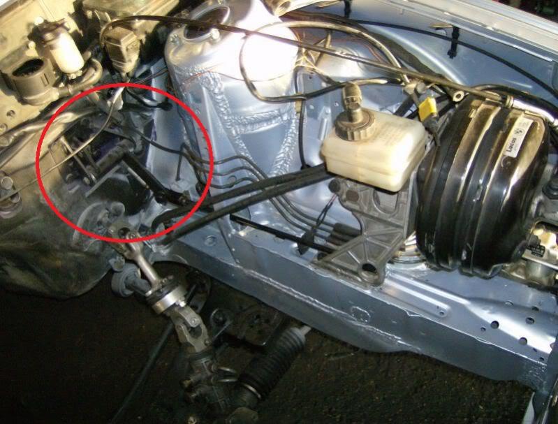

                    I'm finishing up with the final preperation, and parts collection for the major componants of my M60 swap. I ran across this picture, in this thread:
                    Can anyone tell me what car the part that is circled is, and what car it came from? or is it a custom part? I had an idea to basicly build the same thing, but if it's available off the shelf, or from a junkyard somewhere, I'd rather go with that.

                      #55
                      My understanding is that is a custom built part. I will be building something very similar to that for my swap. It seems like the most simple option for the booster swap, because I think you can get away without having to cut and weld on the brake pedal = Less headache!

                        #56
                        Two of my knock sensors are also broken..
                        Well, Custom build it is....
