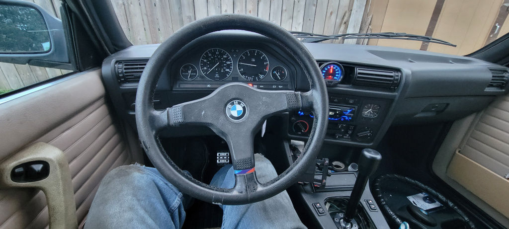

                  Another update.
                  new shit installed. Front coils installed, new front wheel bearings and hubs, new steering rack, and added power steering. Wish I had done that a long time ago, so much nicer to drive at low speeds. Having actual shocks jn the front is nice also. No more bouncing, and no more sounding like someone hammered my shock towers with every tiny bump. For now, I did keep the Camero rear shocks and H&R springs. I am still undecided on installing the stuff that came in the coil over kit.
                  Next big thing on the list, ditch the ghetto home made shifter and linkage, amd get a good body mounted shifter and DSSR.
                  Car still fucks.

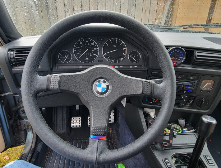

                        More new parts acquired, I picked up a Garagistic Solid Chassis Mounted Short Shifter, to replace "Ghetto-shifter 2.0," and I also got an PMC Adjustable DSSR From Drift HQ. I'm hoping to get those installed in the next day or two. it will be nice to have a shifter with less side to side play. front to back, It's already super notchy.
                        Dumpster Fire Pilot
                        • delamaize
                          • Nov 2013
                          • 1465
                          #177
                          Got the Garagistic Solid Chassis Mounted Short Shifter, Installed, and the PMC Adjustable DSSR over the last 2 days. Got everything installed, Including the offset Gearshift rod joint included with the DSSR. And tried to row though the gears while running, while it was on jack stands. Yeah, the DSSR Hits the output flange/Guibo on the transmission. It wasn't by much, so I ended up going to my local hardware store, picked up a grade 8 bolt, and Nylock nut. Drilled a hole though the entire thing, between the 2 jam bolts. Then cut off one of the ears that held one of the jam bolts, filed it down, and reinstalled it. Nothing is hitting now, even under hard acceleration. It's nice having a gear shifter, rather than a mystery stick, like ghetto-shifter 2.0 was. So crispy, so much better.
                          Sadly, I was so frustrated, and tired, I didn't take any pictures during the whole process. I did take this installed shot.
