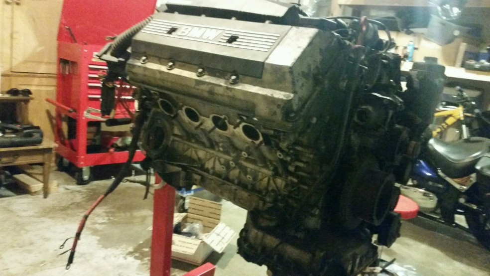

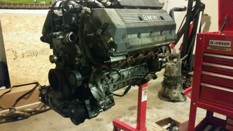

                          Brought the engine and tranny over to the house tonight, and started the tear down.

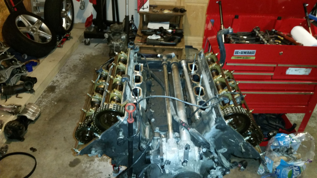

                          Got the exhaust manifolds, the engine mount arms, Oil filter housing, alternator, Intake manifold, injectors, Head covers, coils, plugs, and wiring harness off the long block tonight. Tomorrow I may attack the water pump, coolant tubes, the passage on the back that connects the heads, and I may attack the valley tray also. Ultimately I want to get this torn down to a long block, then check and/or replace everything that needs to be replaced.

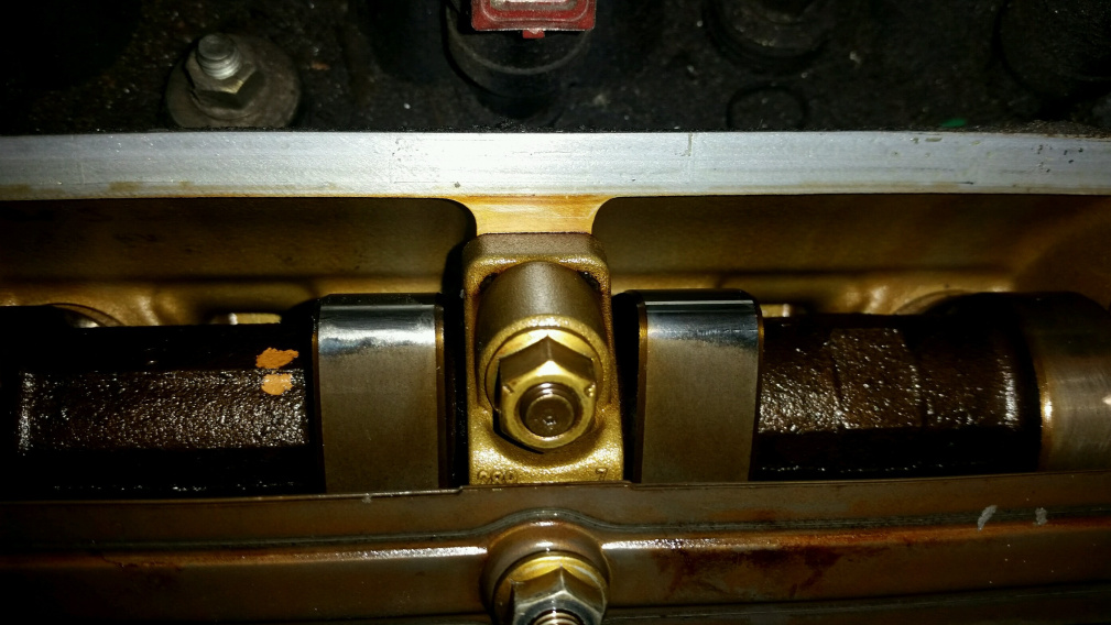

                          Everything looks good, the oil that was in the filter housing was pretty clean, and the cams have pretty much no wear on them. I have one knock sensor that is pretty broken up, and the others have small cracks in them, So I'll need to replace those. Plugs look good. so far no stuck bolts, and nothing broken so far.

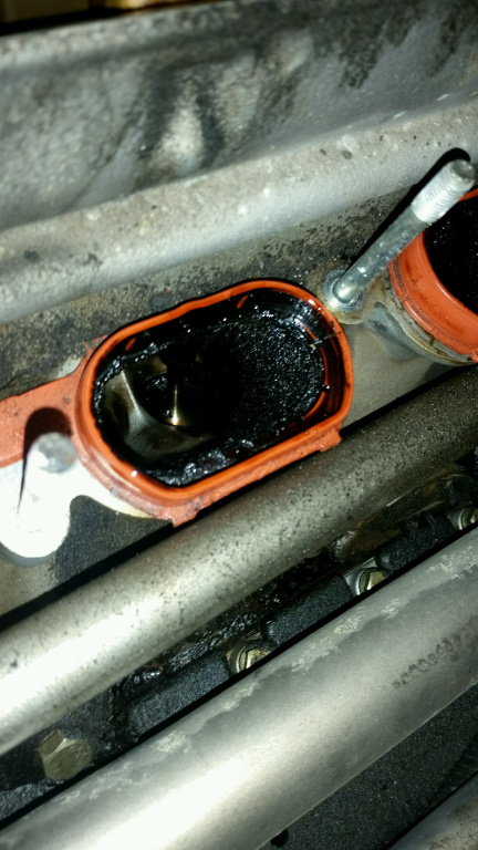

                          so much carbon, Don't wanna pull the heads though, gotta figure out another way to clean it.
                          Also, does anyone know if the intake can be put into a parts cleaner without damage?

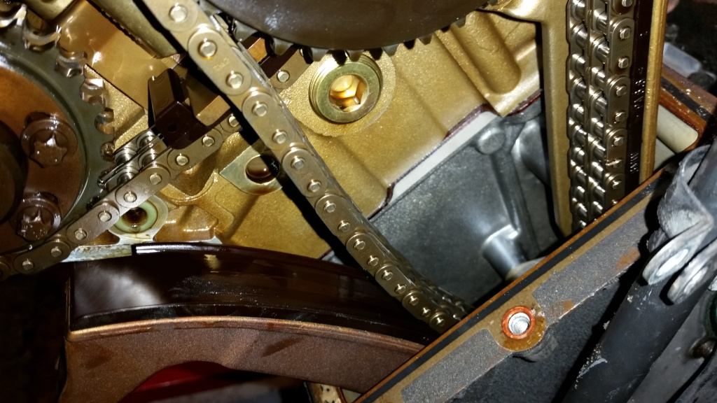

                            A little more progress on the tear down, Timing chain guides look like they brand new, no wear marks at all, and from what I can see, they are totally intact. Chains also look fairly new. Water pump was shot, Impeller was pushed towards the back of the motor about 1/8", but was BARELY not touching the inner housing. I suspected this though, with the damage to the car. So far nothing out of the norm seen, Matter of the fact, I suspect that this was a low mileage, well maintained engine.
                            The valley pan shows no sings of leakage, or anything. I have heard that, if you're going to have broken bolts, or anything like that, it's going to be there. So, for the time being, I'm going to leave it be.
