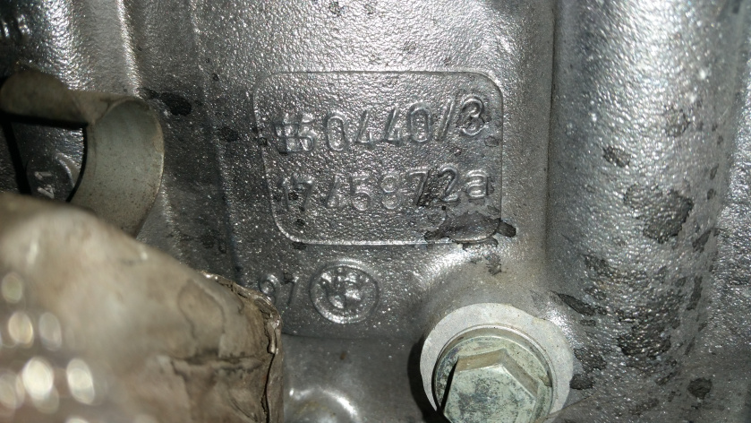

    Also, I found a BMW DOT-R on the rear of the block, above the Valley pan, which reinforces my theory that, this engine one of the good Alusil block replacement, the numbers confirm this. So the likelihood that it has been rebuilt is now pretty much a sure thing.

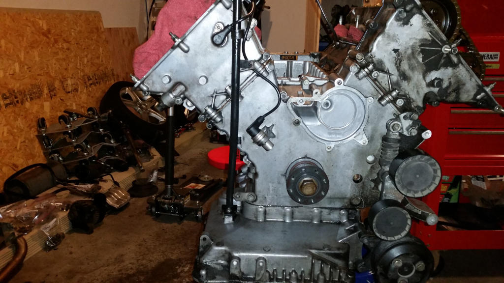

          More cleaning, and more assembly over the last few days. New water pump is on, Valley tray is back on, New Exhaust Manifolds, engine mount arms, and X5 oil block are on. Also took care of the carbon build up in the intake runners, and intake manifold. I gotta clean up the oil filter housing, and the alternator for reassembly. then at that point I am pretty much at a stop until I can afford new knock sensors. The ones I have are beyond toasted. The plastic housing on all 4 units are cracked and falling apart.

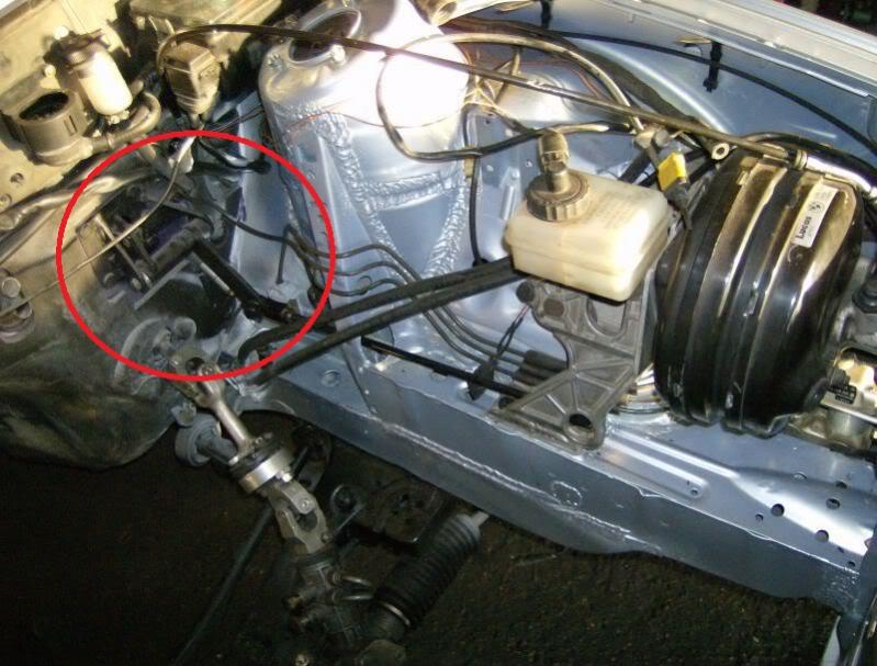

                      I'm finishing up with the final preperation, and parts collection for the major componants of my M60 swap. I ran across this picture, in this thread:
                      Can anyone tell me what car the part that is circled is, and what car it came from? or is it a custom part? I had an idea to basicly build the same thing, but if it's available off the shelf, or from a junkyard somewhere, I'd rather go with that.

                        My understanding is that is a custom built part. I will be building something very similar to that for my swap. It seems like the most simple option for the booster swap, because I think you can get away without having to cut and weld on the brake pedal = Less headache!

                          Well, Custom build it is....
