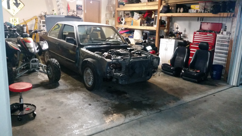

Got the garage all reorginized, and cleaned today, despite being sick as fuck. Once I got the E30 in there, I decided now was as good as a time as any to get started. Took about an hour and a half to get to where it's at now. The lower mounting point on the left side fender was all bent up and fucked....

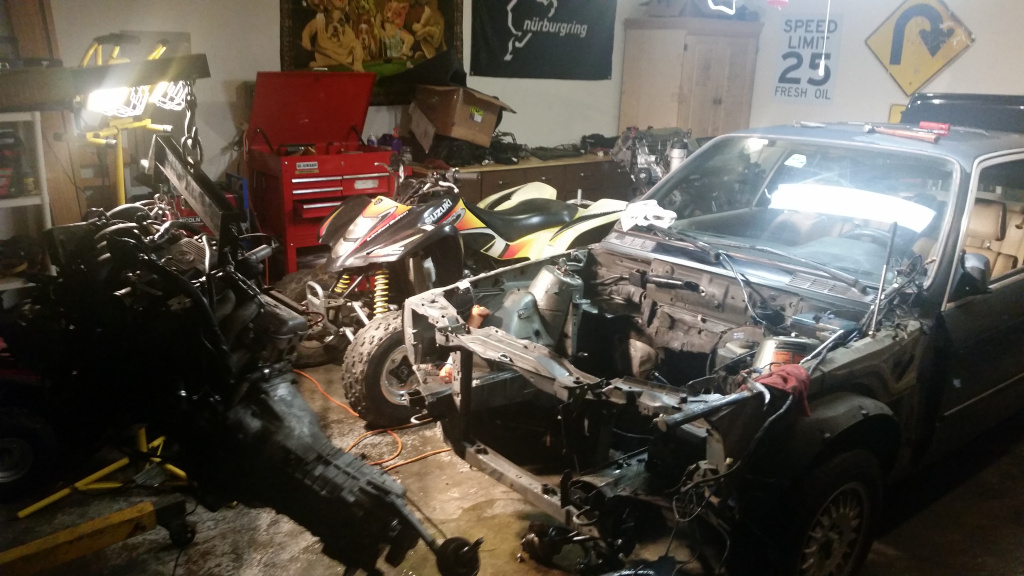

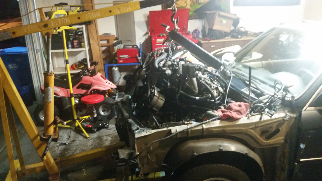

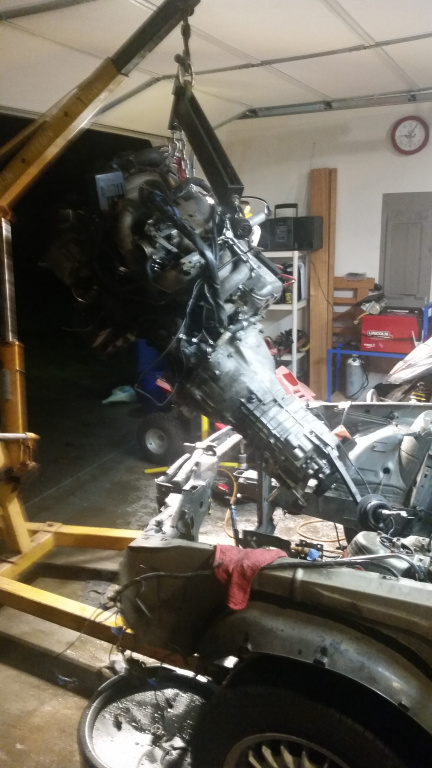

Tonight, when I got home from work, I decided I was going to pull the exhaust, well once I start working, I can't stop sometimes. Needless to say, I got the M20B27 and tranny yanked out. I got a lot of cleaning to do. I also discovered that my power steering leak might not be in the rack, I think it may have been leaking from the bottom of the reservoir, judging from where the oil and grease is in my engine bay. I still need to decide if I am keeping the power steering or not, I do have a block off plate. Also, does anyone know if I can get away with a E36, M3 or Z3 rack and the M60 swap? I have heard conflicting information if it will work with the standard Garagistic Engine mounts arms and poly mounts?
Anyways, Here's the pictures.

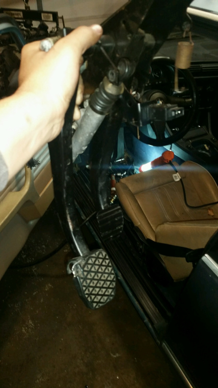

Small progress tonight, master cylinder, and pedals are out of the car. Hopefully this weekend I can roll it back outside, and start cleaning the engine bay.

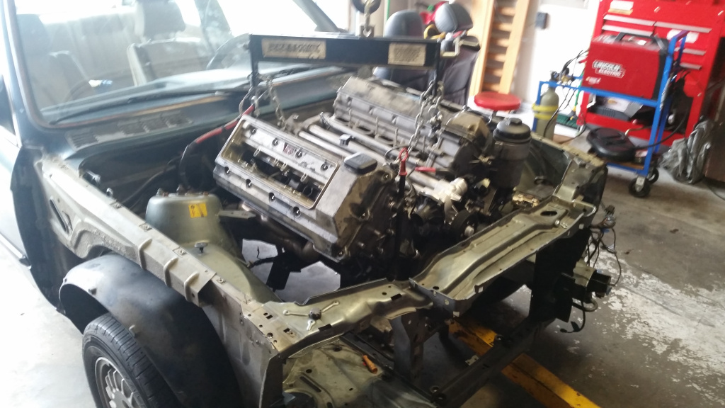

Maston came down this morning, before work, to help with some of the welding that needs to be done. Well I didn't have a good evening the night before I'm a firefighter, and we had a LONG night. He said he wanted to do something to "cheer me up." So he talked me into doing a test fit without the trans. Overall, we are looking good, It's not in the right mounting holes on the subframe, but it still looks pretty good. Once we get some areas marked we need to clearance, We will pull it back out, and get more done, like cleaning and painting the valve covers....

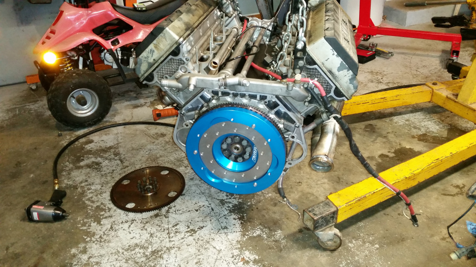

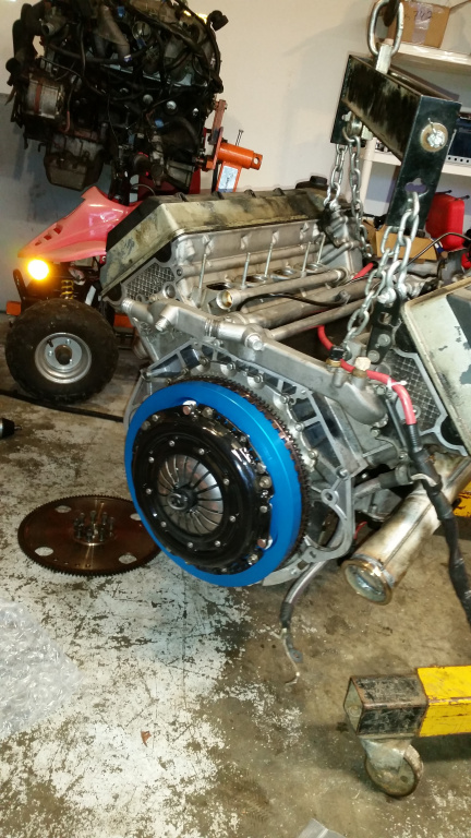

More things happened, we pulled the flex plate, and installed the UUC flywheel and new pilot bearing. Kinda sad that no one will ever see this flywheel, once it's in the car. It's so pretty.
We started putting the clutch on also, but we discovered that half the bolts from the M20B27 clutch were 8.8, and the others were 10.9, so this is as far as we got tonight. Maston lives close to a Tacoma screw, so he's going to pick up some 10.9 bolts to replace all the Pressure plate hardware.
The plan was to get the transmission married to the motor tonight, but without the pressure plate hardware, we are kinda stuck. Instead we installed the subframe spacers.
