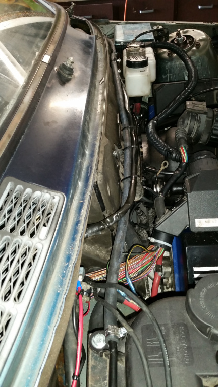

                      Got a metric shit ton of little shit done on the M60 swap today. Mostly wrapped up little stuff.
                      Got the wiring harness adapter shortened, covered, and cleaned up.

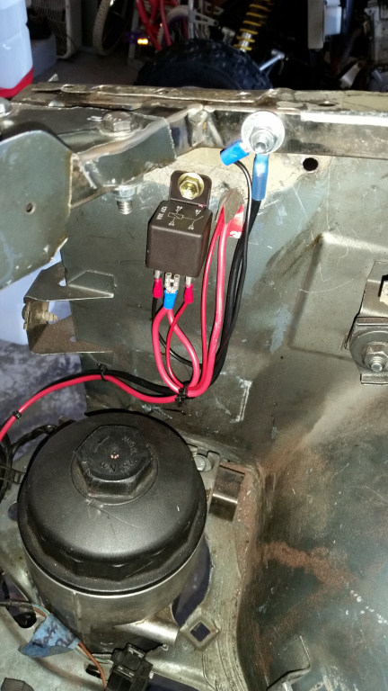

                      Wired up the fan to a factory button in the cab. (just until I figure out how I'm going to wire it for auto.

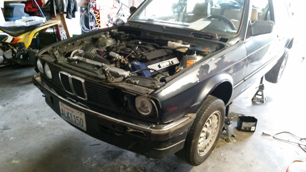

                      then finally got motivated to get most of the body put back together. I left the hood off for now.

                        Maston came down, and we got the brakes bled, clutch bled, double checked everything, filled the diff, put the hood on....
                        Woo! First drive! Still needs o2 sensors and exhaust, but I got to drive it!
