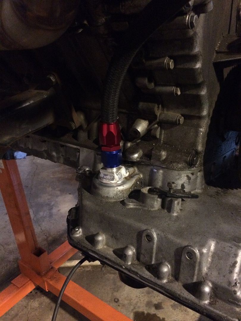

    Mocked up oil drain
    Because V8

            Anyone got any ideas on where to plum the Feed? Out of the Oil Filter? Find a Oil Vein in the motor?

              Originally posted by driftingminor913
              Mocked up oil drain
              I suggest the oil pressure sensor on the oil filter housing

                Can anyone tell what's the nipple off to the side? I had it capped when I ran it last
                  The oil drains out of the filter housing through that nipple when you remove the filter cap

                    You're best bet is to run a tee off the oil pressure sender on the lower left of the housing.

                      Ahhhhhh okay cool

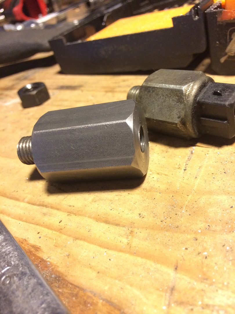

                                Turbo oil feed adapter made for the oil filter housing
                                Turbo Oil return welded in place
