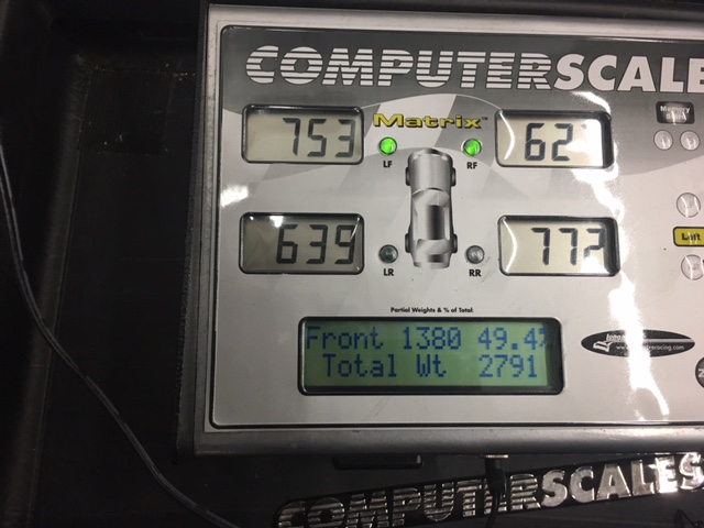

    Just weighed the car with the completed S62 swap. It's a 1991 318is with sunroof. I was hoping to stay in the spirit of the 318is and keep the overall weight low, without resorting to stripping anything out, as it is my daily; even has a Lukebox. But no A/C (not needed here in the PNW). It's now got a 2001 S62 and the E34 530i 5 speed. UUC lightened FW and a street/sport clutch. Front and rear subframes have been beefed up and the diff has the secondary mount and finned cover. Heavy duty driveshaft and halfshafts. Single 2.5 exhaust with a dump valve rather than a dual setup.
    318is curb weight was supposedly 2602 and weight distribution was 54/46% F/R. according to the specs I've seen online. My car only had 2 gallons in it when weighed, so it was 84 lbs lighter than if it had a full tank (I believe curb weights include a full tank). Anyway, check out the new stats:
    I can't believe it. Only about 200 lbs heavier, and with a better weight distribution (almost exactly 50/50).

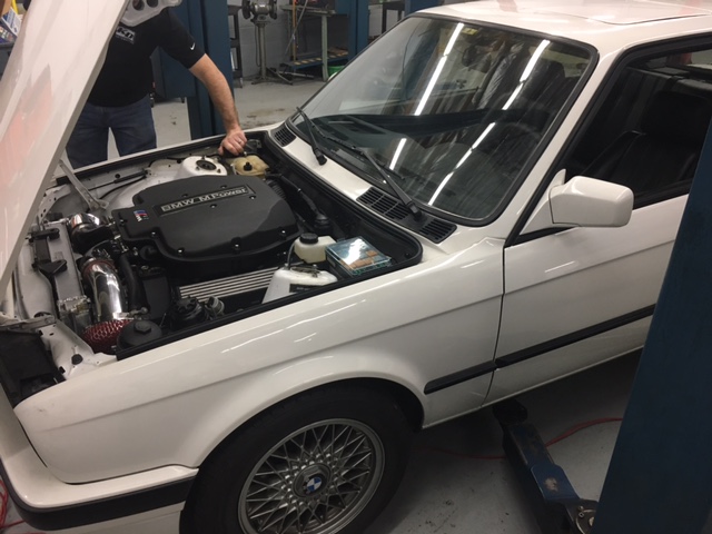

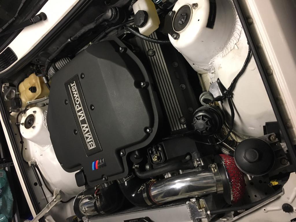

            No build thread, as I didn't do the swap. I'd love to be that talented and have that kind of time but I am sorely lacking in both. I did the research and collected all the parts but a buddy of mine did the swap (Kevin at KD Motorsports in Redmond WA). It is a 2001 S62 out of an M5 with an E34 530i 5spd. I bought the entire swap kit from Garagistic (mounts, exhaust manifolds, pedals, driveshaft, subframe reinforcements, secondary diff mount). Its running the biggest Mishimoto radiator that would fit, but no oil cooler as there is a coolant/oil heat exchanger in the S62. It actually runs so cool that the aux fan has never kicked on in the 3 months I've been driving it.
            The ECU is from a guy in the UK (Adam Ergen). It runs AlphaN so you don't need the MAFs; instead just a temp sensor in the intake. Also deleted EWS, deleted the 2 O2 sensors after the cats, and is supposed to bump hp by 30-40, not that it is needed. It all arrived in a nicely finished loom and was supposed to be plug and play, although the coils didn't fire at first so there were some bugs to figure out. I'm sure it was my fault, as I don't think I let Adem know it was a 318is, not a 325.
            Without the MAFs the intake was easier to complete, but I still need to powdercoat the piping and fashion some air boxes around the filters so it is no longer a HotAirIntake.
            The exhaust is the modified X5 manifolds to a 2.5 on each side, merged to a 3 to a cat, then a dump valve, then a single 2.5 to a resonator and the quietest muffler I could find, and a single outlet. It's fairly quiet until you open the dump valve, and then it sounds like a warbird. I think it's awesome, my sons think it's awesome, the wife says Oh My God That Is So Tacky.
            The brakes were abysmal when we got it back on the road; the switch to non boosted didn't fare well with the RX7 BBK I had. Also the MCs that come with the kit are not the best quality; I already had to replace the clutch master once (big hassle, as the dash has to come apart to get at them). It was undrivable with the RX7 BBK so it is currently running stock brakes with 5/8" MC front and rear, and it will lock up, but the pedal effort takes some getting used to. If my finances recover I plan to put in a nice BBK setup from Massive, although it will mean I have to swap out the Euroweaves and lose a bit of the stealth look. Of course having some more rubber on it will be a good thing; you can get wheelspin at 80mph on dry pavement. It has a 2.93 LSD at the moment but a 2.79 would be better. I have one in the garage but it needs to be refreshed.
            I'll post more pics once we get some better weather; it's been nasty here lately. Also will get it on a dyno after a bit more shakedown time to make sure all the little issues are resolved.
