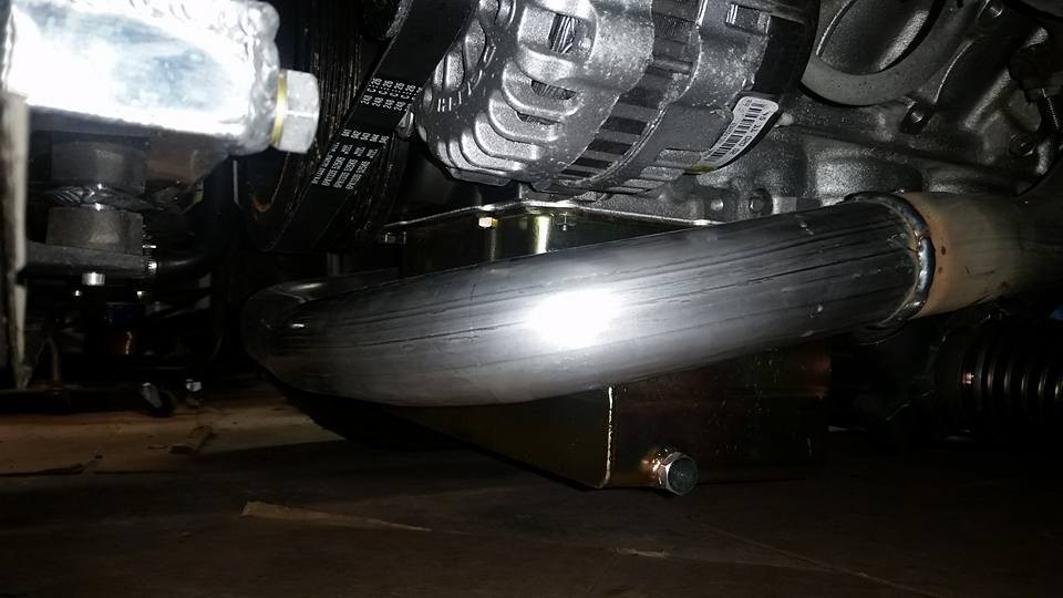

    Does the canton oil pan hang lower than the crossmember?
    First e30 - 1991 318i 4 door
    • DividedBeing
      • Dec 2019
      • 116
      Sikky's site says 5" from the block to he bottom of their pan. The Canton pan is 6". It's going to depend on how my motor sits with the mounts when they get here mostly.
      You can get an idea from Project Snow White on here. Looks like it's hanging down a bit, but if it is, it's only 1" more than the Sikky Pan would.
      None of the pictures of the pan in his build are great angles, but you can get an idea from seeing all of them together.
      Another thing to keep in mind here is that his motor's sitting a lot lower than standard mounts due to his mounting solution.
      I saw him putting a truck intake on that thing and was like "Wait a sec...."
