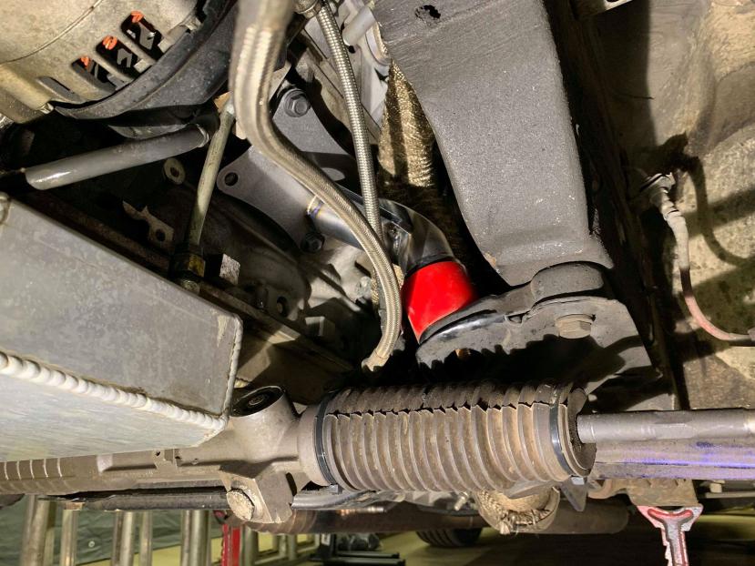

                              If you're going LS,
                              Don't pay for the Sikky Mounts.
                              Buy some from this guy Alex Volkman. $275 shipped, plus I paid $50 for some poly bushings from AKG:
                              https://www.akgmotorsport.com/produc...IFvQGWeMRUHnfE
                              I'm pretty sure he's on here, but his instagram is here.
                              I just ordered a set. He said they'll be here in 7-10 days, and I've seen a lot of guys praising his work on the BMW LS Swap Group (which you should definitely join)
                              Click image for larger version  Name:	mounts.jpg Views:	0 Size:	92.7 KB ID:	9904422
                              Click image for larger version  Name:	mount2.jpg Views:	0 Size:	92.5 KB ID:	9904423
                              Click image for larger version  Name:	mount3.jpg Views:	0 Size:	70.6 KB ID:	9904424
                              Click image for larger version  Name:	mount4.jpg Views:	0 Size:	53.3 KB ID:	9904425
                              Click image for larger version  Name:	mount5.jpg Views:	0 Size:	95.4 KB ID:	9904426
                              Also, I opted for the Canton Racing 15-276 Pan, which I found for $359 new on Ebay. Basically, avoid Sikky for a lot of stuff because it's overpriced (even though it's generally nice stuff). You can piece a lot of their stuff together, or go with alternative and just as functional options for much cheaper. For instance, I have everything I need for an oil filter relocation kit with AN lines/fittings and it cost me $70 vs $174 because I pieced it together myself.
                              Save money where you can, but understand it's an expensive goddamn project. You get nickeled and dimed to death by a lot of the small stuff, and you've gotta be careful about mission creep.
