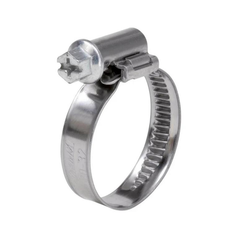

                            Wuerth Zebra clamps are similar to OE and I've really enjoyed using them to replace even the T-bar clamps which couldn't cut it for me.
