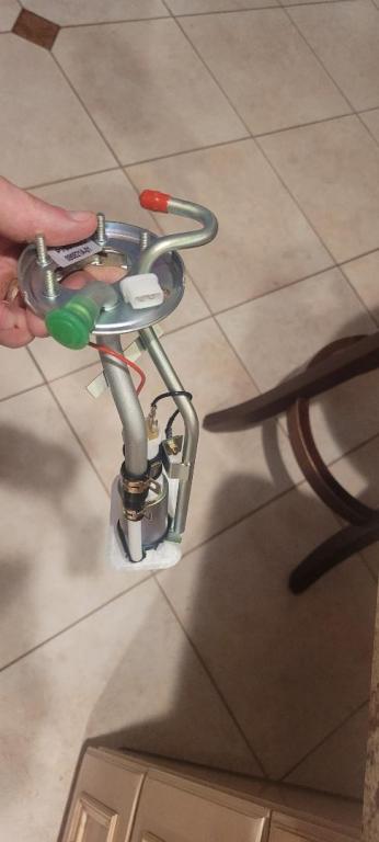

                      I live in NY and this baby has 330k around town miles. I have a beautiful 2002 f350 4x4 that never sees the salt. This on the other hand...... We just welded in a floor on the passenger side. BTW, this pump worked when I took it out. How? I do not know. I bought the Carter pump and this is what it looks like.
                      • moatilliatta
                        • 6158
                        Looks like it should work. The only troubles I've had is the adapter rubber coupler disintegrating after half year on the airtex, looks similar, but now with squeeze clamps.

                        • clydesdale
                          • 631
                          Hmmm, I wonder why the hell it would disintegrate. I'd hope they use fuel injection hose or such.
