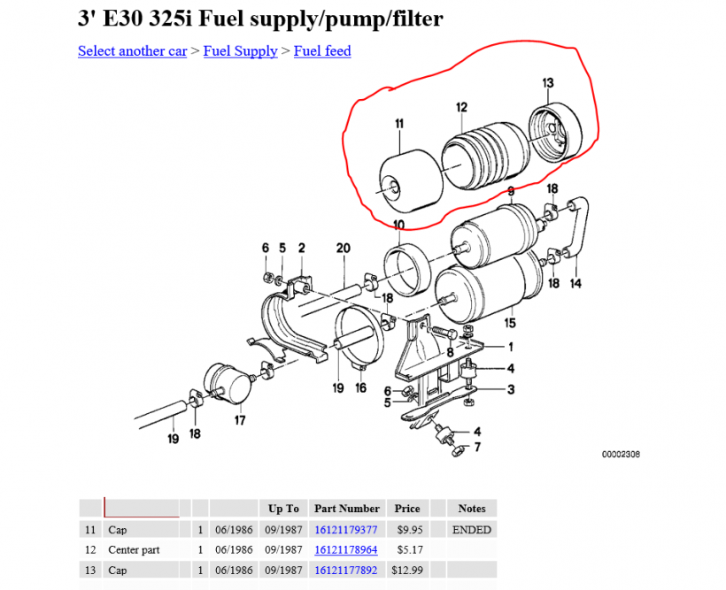

    Rubber cover that goes over External Fuel Pump. Anyone knows the function of this?
    Has anyone seen this rubber cover that goes around the external fuel pump?
    Does this help with sound deadening to help prevent the sound from the fuel pump to be heard inside the cabin?
    I am attaching info from RealOEM. Unless I am mistaken, this did not come from factory with this, did it?
    I tried searching for the part numbers through Google and R3V, I could not find much info other than one person selling it from a E28 forum.
    The real question I have, is what is it actually for? Is it just to prevent dirt to get on the fuel pump, or does it serve a purpose as a sound deadening contraption?
    https://www.mye28.com/viewtopic.php?p=1509443
  • reelizmpro
    • 9531
    I don't recall seeing that but it looks like it was only used from 06-86 to 09-87. My guess it was there to dampen the noise of the pump.
