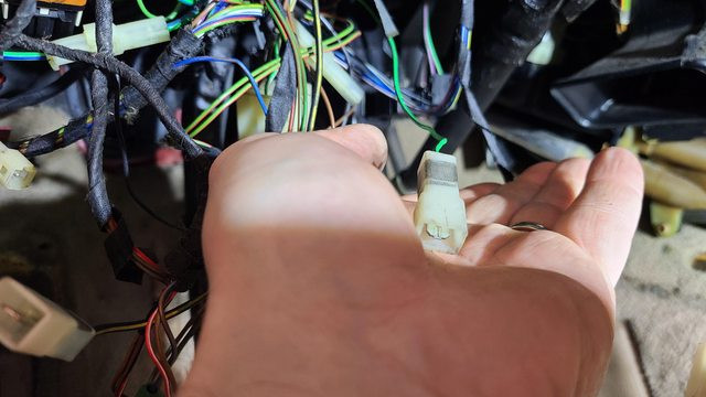

    2. Round bullet (male) inside a white connector at the end of a red wire with black stripe

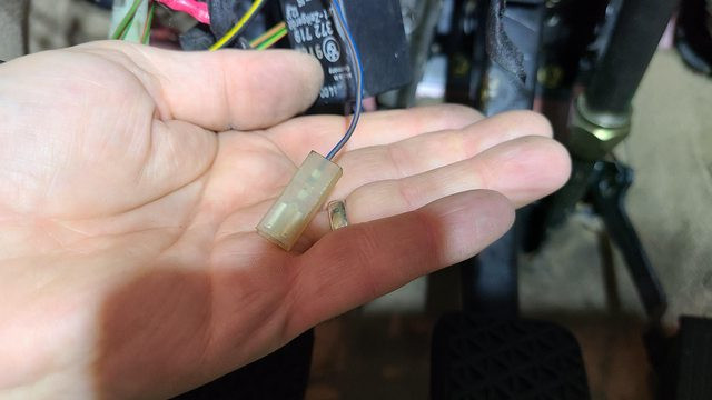

    3. Flat blade (female) inside a white connector at the end of a blue wire with gray stripe

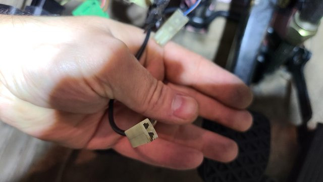

    4. Flat blade (female) inside a white connector at the end of a black wire

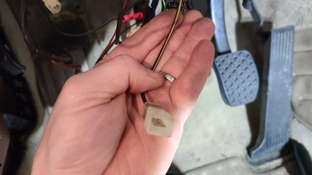

    5. Flat blade (male) inside a white connector at the end of a black wire with yellow stripe

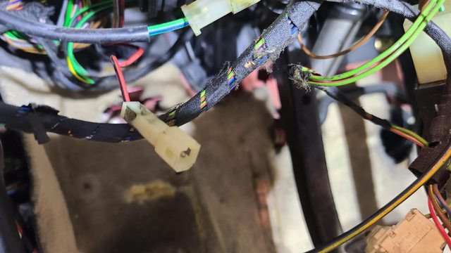

    7. Flat blade (male) inside white connector at the end of a green wire with black stripe

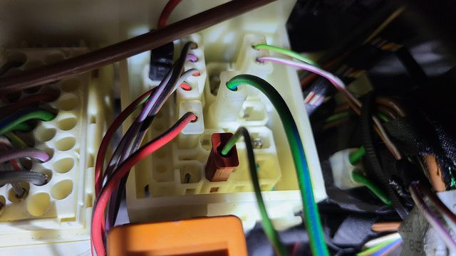

    8. in a connector block behind the gauge cluster, there is a connector block. Some spaces are opened without anything connected, one with a small bullet (bottom row) and others with bigger bullets (males)
    9. Lastly, in the driver-side kick panel behind the speaker is a white connector with two wires, green w/ gray stripe and brown with blue stripe

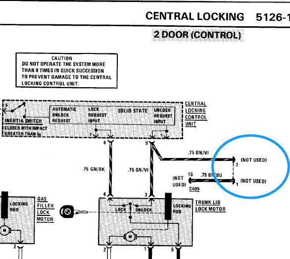

                    Somehow, i'm finding that it's not so simple. Even after studying the ETM for 1989 + the addendum for 1991, I still struggle to make my way from one specific connector to its circuit and purpose. I don't want to sound like an a**; I'm truly trying to learn how to use this guide, but it's falling short for me.
                    One simple example:
                    This connector is present in the LH kick panel, behind the speaker. It is a three-bullet plug with two wires connected (BR/BU and GN/VI)
                    Click image for larger version  Name:	HxwTYifl.jpg Views:	0 Size:	69.9 KB ID:	10117596
                    This should be easy enough as that space is relatively limited in circuits:
                    • radio (6500)
                    • central locking (5126)
                    • interior light timer (6330)
                    • power windows (5133)
                    • power mirrors (5116)
                    Luckily, ETM section 7000-5, fig 3 shows this section with two connectors: C510 and C205. I should be able to go to section 8500 (connector views) to see what each looks like. Not, sorry, not found there.
                    Maybe I can find C510 or C205 in any of the individual circuits listed above?
                    • radio = no
                    • central locking = no
                    • interior light timer = yes, C510 is there but it appears to be a single pin connector with a BR/VI wire
                    • power windows = no
                    • power mirrors = no
                    C205 isn't found but maybe this is a connector that someone relocated from elsewhere, so let's check for two or three pin connectors in section 8500
                    The only ones remotely close are C303 and C304 (section 8500-11). These also appear in section 7000-10 at base of LH and RH "B" pillar. So, relatively close to the kick panel. Though the picture in the ETM isn't great, it looks to show a connector with three wires used. Both of these are also found on the interior lights section (6330) but appear to use pins 1 (BR) and 3 (BR/VI)
                    Maybe this is an edge case and other connectors are easier to trace back, but that hasn't been my experience yet. Looks like I'm going to have to chase them through the harness and/or check for continuity throughout, hoping it provides a hint of what they do.
                    My car was an automatic car with airbag and is now a manual car without airbag, so I'm not surprised to find random connectors dangling. I want to figure out what each is so I can label and tuck them away if unnecessary. I'll be sure to update the post as I make progress.
                    (interestingly, I came across this post where a user had a much worse rat's nest than I do, and asked about this particular connector as well: https://www.r3vlimited.com/board/for...ems#post378611)
                    • BSAmarc
                      • Mar 2024
                      • 21
                      FYI: I found the above connector in the ETM by checking each page for those specific wire colors. Appears to tie into the trunk locking mechanism.
                      Not the preferred way to trace a circuit so still hoping there's a better way.
