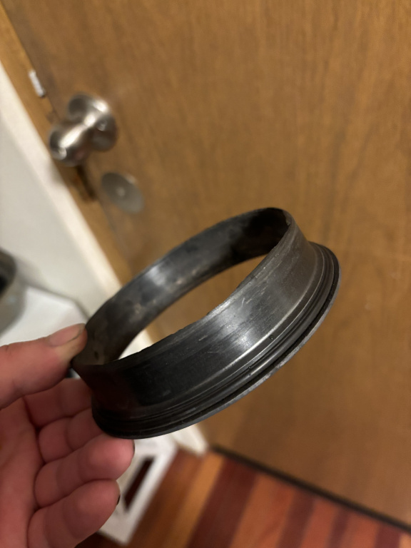

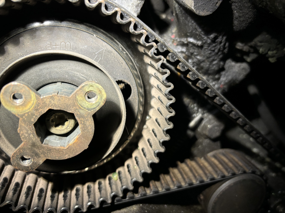

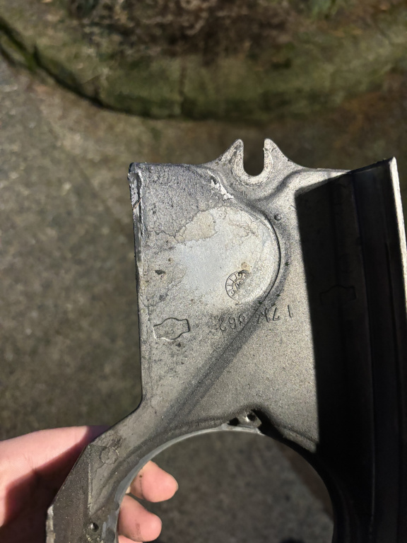

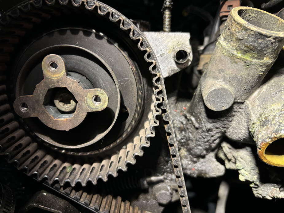

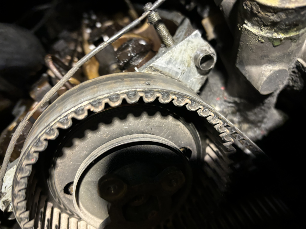

                      Its possible that the cps sensors need work too, but at this point im more invested in the timing. Replaced the belt in 2020 so its about time to replace anyway, pulled everything in prep to check timing and its off by a tooth. More concerning, the belt has worn a track in the timing cover and the cover between where the distributor mounts to the toothed wheel has a mirror finish. The belt is currently tensioned and very taught, when I get home today im going to take off the belt (saw the wear and went inside, called it a night) and inspect for play in the gears and then also replace the tensioner just in case. Yes, I know how grimey my engine is, its getting a new thermostat and all new crank seals and valve cover.
