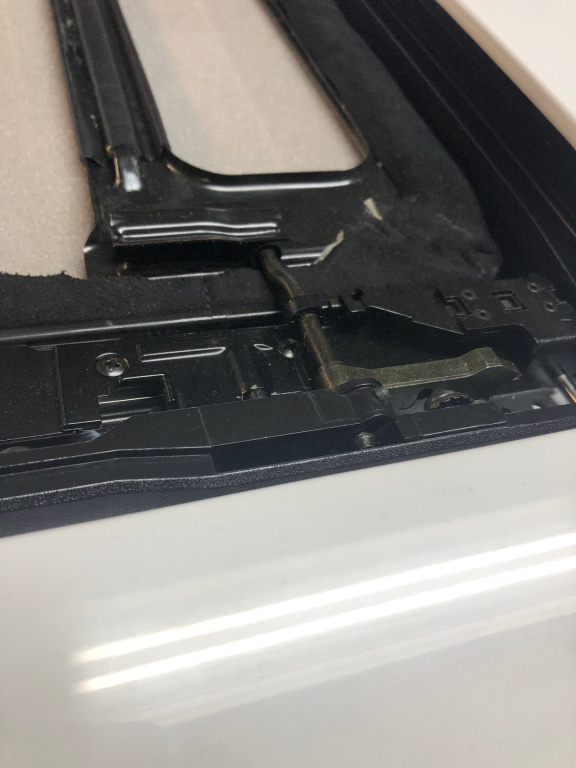

    I'm getting an annoying rattling noise from my sunroof and narrowed it down to missing bushes and roll pins pn 54121843484 and 54121849774.
    #14 and #15 in the realoem diagram. 484 seems completely unavailable. Has anyone found a tried work around that stops the panel from moving up and down?

      So my roll pins seem in decent shape and just need a little bit of lubrication. They can be ordered separately for about $5 each plus shipping.
      The concave bush is not for sale separately but it looks like the whole assembly can be ordered for $220 each with those pieces already mounted. That doesn't work for me since the mechanism works fine but maybe helps you or someone else out.

          Well, I tried some electric tape. That ended up backfiring and stopped the headliner channels from completely slotting over the pins so I can get the pins in the front reinserted. After a lot of mandatory swearing (bc E30 sunroof), I finally got the damn headliner back on without the sunroof getting stuck. It was off ever since I first got the car last winter so I'm pretty stoked I have a fully assembled and working sunroof now.
          Lubed everything, it has fresh seals from the PO so now I just need to check the drains to make sure they're clean.

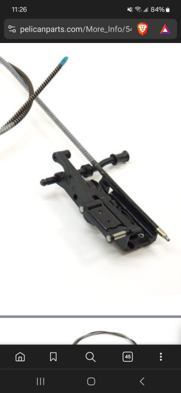

            Schmiedmann in Denmark can supply you with both (left and right) drive cables in the $350 range inclusive of shipping and credit card fees. Your own bank may also charge a foreign exchange fee as well.
            Installing these is not for the feint of heart.
            The other parts commonly to break are the plastic gates, 54121941321 and 54121941322 (#19 on the OEM parts diagram). These are in a similar price range as the drive cables.

              Agreed — I have only seen that concave bushing with the cable assembly. Could be a candidate for 3D printing but I’m not that guy.
              I bought a used set of E28 cables & arms from eBay. Some (but not all) components are interchangeable w/ E30.
              If you do take it apart, I suggest you save EVERYTHING, even broken bits that you think won’t be useful. They just might be.

                  those bushings are only there to operate the cover side of the roof, the interior piece (pull it closed and tilt it up etc). Take that piece off and run it without it to see if that's where your noises are coming from. Sunroof is not actually that complicated as one may think. I had the whole thing apart when the shell was repainted and put it all back together. Not complicated at all
