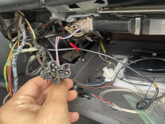

    This group sort-of looked like it would go behind the HVAC panel, but the blue connector should be for the Cruise Control Module, the others... no idea.
    Pretty sure I have a few of these identified. 2 wires for glovebox light, rectangle connector for the flashlight, but the rest?...

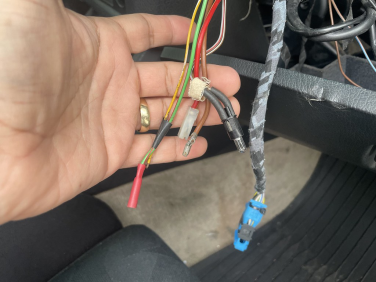

    Finally theres this. No clue at all. These wires/ connector are literally coming off the ECU!

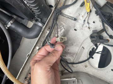

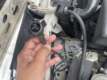

    Now we switch to under the hood. This group is on the passenger side. I believe the boot-ed 2 pin connector is for the coolant that would've gone on the side of the radiator IF mine had the original early model setup, but mine has the late model radiator and reservoir. The long-ish chewed up connector SHOULD be for the exterior temp sensor, yes?
    Those 2 wires Im holding... no idea?... Notice anything else?

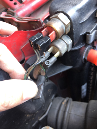

    Now, switch to the driverside. Similar connector to the pass side, but theres a bridged connector too...

      Just consider what's in that area. The small wedge bulb in that area goes behind the HVAC panel. Find out which section isn't illuminated and you'll find where it goes. The red and brown look like cigarette lighter leads. You need to figure out what's not working. It will help you figure out what's what.

      This was only in the 325i cars. I think it was tach signal or OBC related - C104 connector. Does the tach work ? does the CODE function on the OBC work? I did find this thread...

      Air temp sensor that mounts to a hole in your airdam. Circular plug appears to be for windshield washer level sensor. The 2 blade connector is for the AC drier.

      These two are for early model radiator temp switches on driver's side.
          I think these are ABS sensor wires. Those connectors are notorious for falling apart.

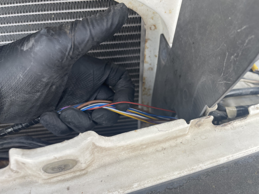

                    Simon, the wiring runs down the driver side fender anyway, pull back the wire wrap, find the wires and just tap into the coolant level circuit instead of running wires all the way from the passenger side back to the drivers side. Also, those later model connectors are also used on the brake fluid reservoir, fuel pump, etc. if you come across a late model parts car. I wish I had cut more of them off when E30's were plentiful at the yards.

                      stripped away and isolated the main wire I need, but it looks like the ground is joined with a few others, so I’m wondering if I can run another ground and use the junction on the inside of the fender? My brain says yea, but what does R3V think?
