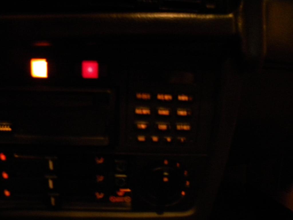

              OBC Fixed :D
              Just an update here. The OBC lighboard is fixed and is now using 2 red LEDs.
              Here's some pictures:

                that's 2 leds? mine was much brighter than that with 2...
                looks good. nice job.
                  you must have used some really bright LEDs, mine looks stock with 2 of whatever I had lying around.
                  Build thread
                  Bimmerlabs
                  • turge
                    • 2576
                    I didn't use the high brightness ones since I would have needed a better resistor. Nevertheless I can see it clearly in day time and really well at night. Probably going to convert all of my other lights to LED as stuff starts burning out.
