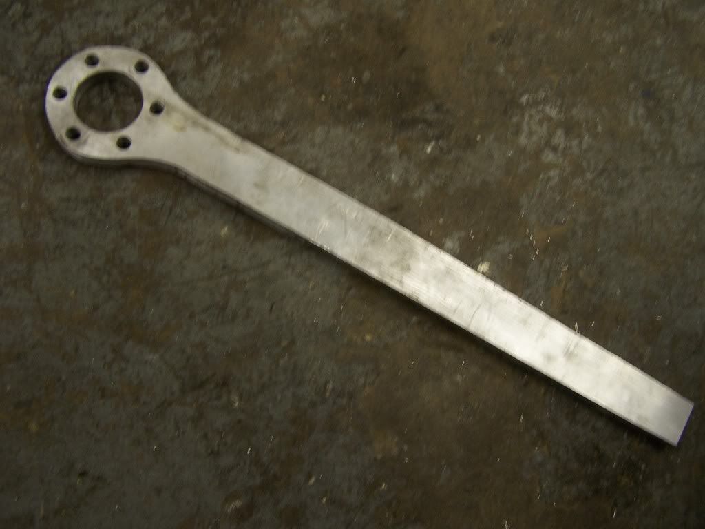

            If you are crafty, you can make your own tool. I just spray painted the crank pulley n a pce of aluminum (steel will work) to mark the holes, drilled them out and used a band saw to cut the shape (jigsaw would work on aluminum too)...

              How does the tool actually work? I was wondering if this was a situation where you could bump it with the starter to loosen it.

                starter is no where near strong enough, sorry bud :(
                You would use this tool, bolt it to the hub, rest it against the frame of the car, and use a 1/2" (minimum) breaker bar about 4' long.

                      I'm sure it is great for the starter too. Making the tool is the way to go.
                      You can buy the tool if time is worth more than money. You could take a long thick piece of mild steel and drill two holes with a drill press, you may have to grind a notch in the edge to clear the center. Odds are you will strip the threads on the bolts this way but if you have some extras then who cares.
