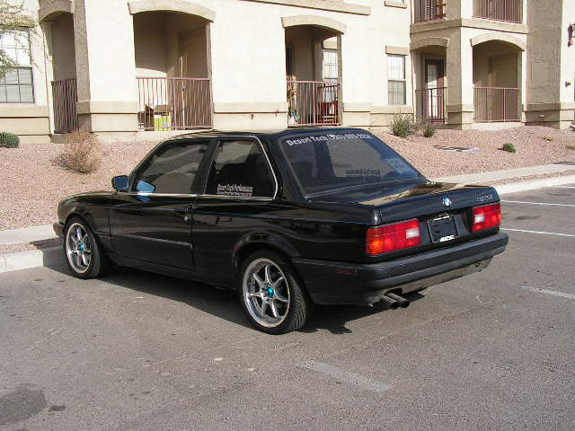

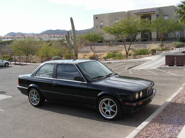

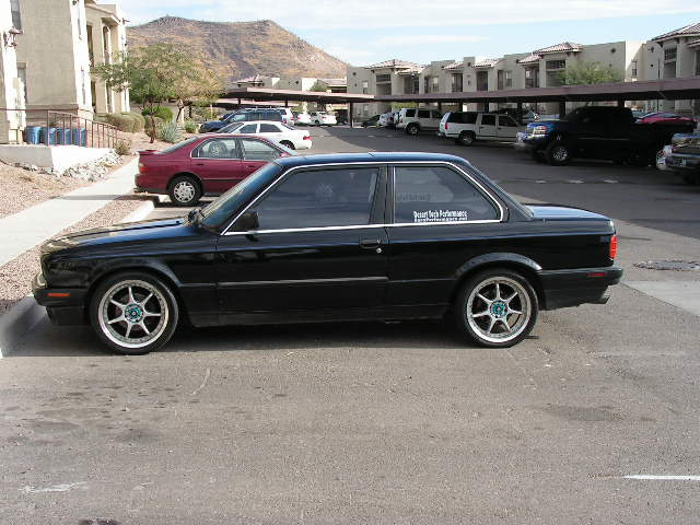

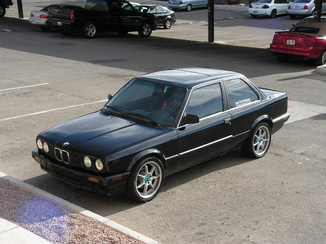

          hey guys, finally got the car back from the shop with the new wheels and differential installed, I think they turned out pretty nice actually (especially considering both were free technically). I will probably eventually paint the centers of the wheels black to match the body color but for now i think its great. One thing u will notice though is the front is much lower than the rear, thats b/c i removed 250lbs off the back of the car and I now need to start at the front of the car. As soon as I do that, the car will even out. anyways here are the pics...

            How do you figure you removed 250lbs from the back??
            And those are probably one of the ugliest wheels I've ever seen on an E30.

                              Hey guys, the car came with TSW hockenheim CHROME 16's which are a whopping 23.6lbs a peice, these enkei rs evo's are only 19.4 for 17lbs (inch larger in diameter and lost 4 lbs a peice, thats not bad). Also not to mention the wheels had almost new 215's instead of the dinky 205's that were on the older car.
                              Yes i know the wheels are not the BEST looking... but for free... you can't get much better. I will be replacing the blue center caps with BMW emblems which are flat and much better looking. Also I eventually plan to black out the centers just exposing the lip.
                              The stickers say "desert tech performance". DTP was my first sponsorship and I have another one on the way. They do all the work on the car and David is one of the best and nicest mechanics out there, he hooks me up all the time b/c of the sponsorship, not to mention I'm his best customer.
                              as far as weight, I removed tar mats, Spare tire, jack, tool kit, carpeting, rear seats, rear door panels, some of the tar matting under rear seats (not as heavy as the trunk but still adds up), and also the Odyssey LTW racing battery (roughly 15lbs, saves about 30-40lbs depending on what u compare it to). I also got racing shell seats which are about 10-11lbs each with the mounts. I still have front carpeting in place and basically everything in front of the front seats is completely stock minus headunit which i took out already. once I start that the car should even out alot more (fan delete, AC delete, front carpet delete. Also stock exhaust system is still in place so when i change that out it will save alot of weight as well (roughly half the weight typically). replacing everything from just after the header flange with mandrel 2.5" piping. my goal is 2200 which wont be easy but im hoping I can do it.
