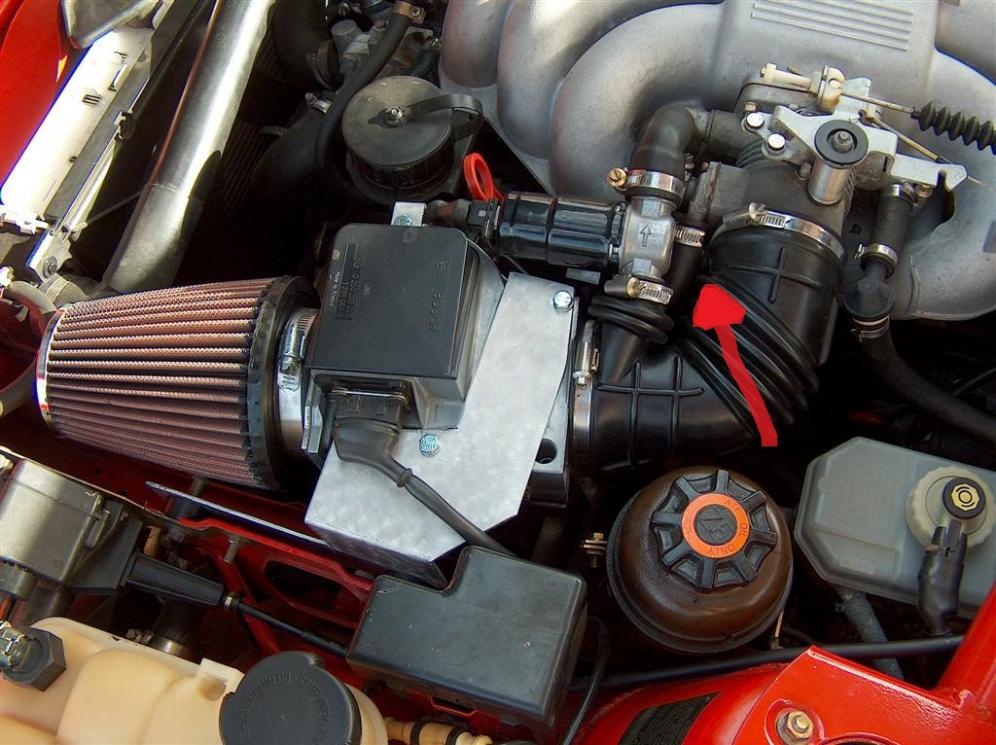

        I recently atempted the m30 AFM swap in my 87 325is. it had a 91 motor swap done by the previous owner. i actually bought the car off of this forum. but anyway my issue now is that after i installed the AFM the car stalls after 15 seconds of idling.
        I also noticed that there are two completely missing vacuumn lines from underneath the ICV. anybody know where they go and what i need to route hem too?
        • ThomasK
          • Oct 2013
          • 15
          #109
          here's what I'm talking about when i say missing vacuum lines

            that looks like arrow points to the throttle body heater which is coolant flow and is basically useless in warm climates
