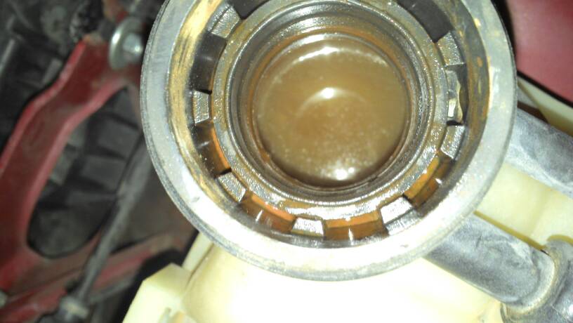

    Coolant is still brown and fishy
    Just flushed my nasty coolant that was a dark brown/black from my recently purchased junkyard car and it returned after a few days. Should I just keep flushing it? What is up with my coolant system?
    Sent from my XT890 using Tapatalk
    Flush it 10x times, mine was like that. Also if its that dirty, make sure your radiator isnt getting clogged.

      thats how it looks when oil passes to the coolant passage ways. you might have a blown gasket or cracked head somewhere..
        Its not oily though but I am getting oil in my exhaust so that might make sense. I threw in the Coolant flush+cleaner and will report back after I flush it.

          looks like a small amount of oil to me, too.

            Head gasket for sure

              Rent a radiator pressure tester from the auto parts store. Pressure the coolant system and then wait a half hour. If it is still at the same amount of pressure, no head gasket leak. If it drops, then you have problems.

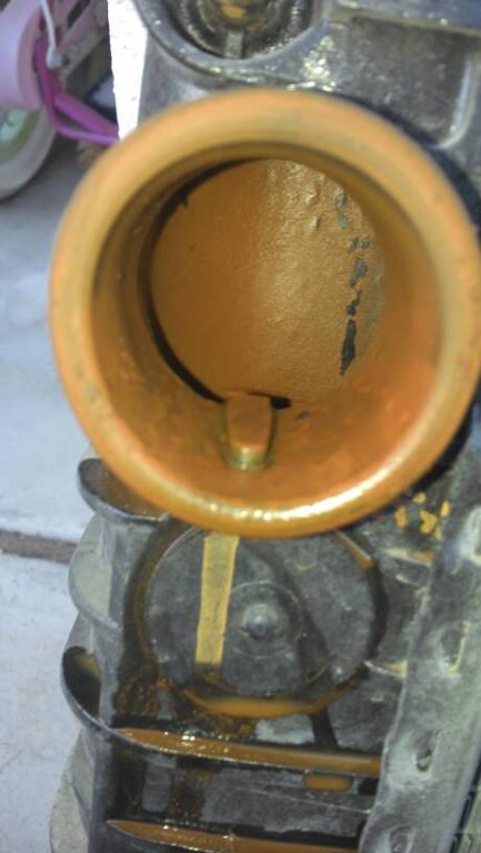

                            So I just pulled the radiator and damn was it disgusting. No wonder my radiator drain plug didnt work. So much sludge came out of it. I just need a way to figure out how to clean out all of the sludge in the system all of the hoses are cake inside with it.

                              Picture of the inside of the radiator.
