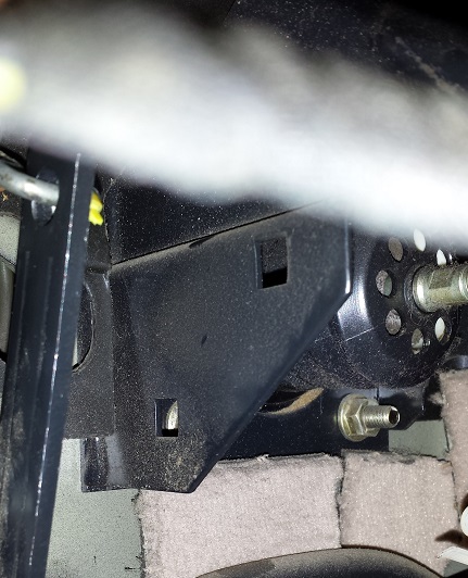

                      I yanked all the parts off a 90 airbag car to swap into my 89 non-airbag auto and I was looking under my dash tonight and noticed there's nothing for the clutch master to thread into on the auto pedal box. There are just two square holes punched in the bracket. I could run longer bolts through there and use nuts but it looks like the MC would tend to slide around. Is there supposed to be a square nut welded in there or what?
                      Also, this airbag car does have the big spring so that rule is apparently not universal.

                        well, firstly you don't want an airbag pedal box in your non-airbag car. the way the steering column mounts is different, I'd be looking for a non-airbag pedal assembly.
                        Interesting that non-airbag pedal boxes aren't all the same but that makes more sense. it's a lot easier to change than on an airbag car. on mine, I just bolted the MC right to the stock auto pedal box.

                          In that case I'll just have to get creative and make it work ;D
                          For future reference, I've attached a picture of what my pedal box looks like with those square holes.
