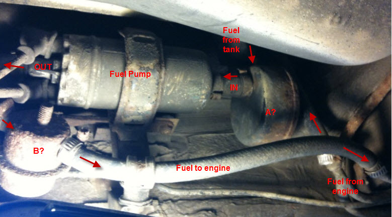

    So I could get away with ripping out the pump and connecting the "fuel from tank" line to "fuel from engine" line? Just getting a 8mm->12mm barbed reducer?
    Schwarz 1985 325e
    • TobyB
      • Oct 2011
      • 5213
      Probably. Unless the 12mm line exploded because it's old and not made for 43 psi...
      then it would explode in a fireball that would consume at least half a town.
      Or not.

            Completely successfully. Car runs great.
            "all" I had to do was to drop the tank and re- plumb it...
            ...and get a return line rigged!
