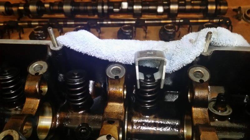

    ...to fit the spring retainers with clearance for the keepers:
Name:	4 adapter fit to spring retainer.jpg
    Place a towel around the top, side, and bottom of the head where you'll be working:
Name:	5 place towel around head.jpg

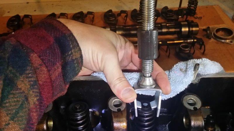

    Place the adjusted adapter on the valve spring retainer:
Name:	6 place adapter on spring retainer.jpg

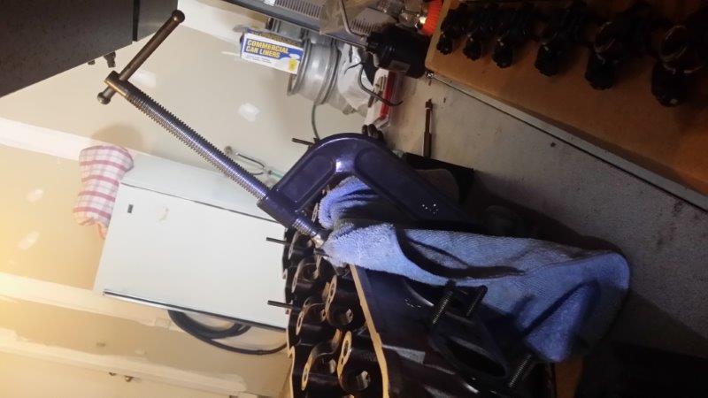

    the next step is to take your 6" c-clamp and place the fixed end over the valve (on the bottom), making sure the towel is between the tool and the head in all places:
Name:	7 6 inch c clamp over top and bottom.jpg

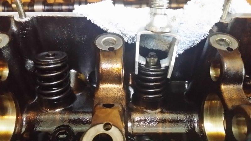

    hold the clamp assembly in-line with valve stem/spring assembly as you compress the spring. the adapter will stay on top of the spring due to it's retaining tabs:
Name:	8 keep clamp in line with valve and compress spring.jpg

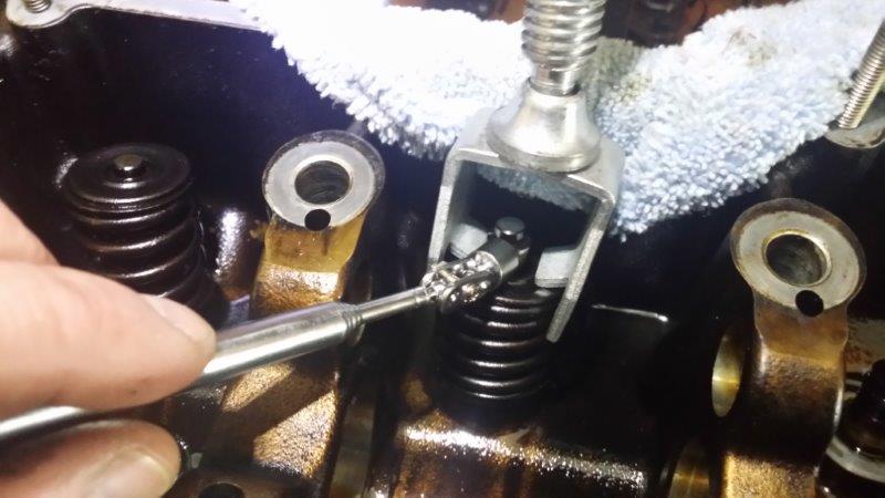

    continue until the retainer clears the keepers:
Name:	9 compressed spring.jpg
    Use a magnet tool to remove the keepers:
Name:	10 use magnet tool to remove retainers.jpg

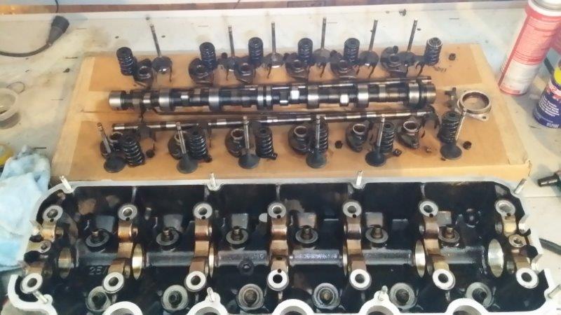

      And here's what you end up with:
Name:	everything removed.jpg

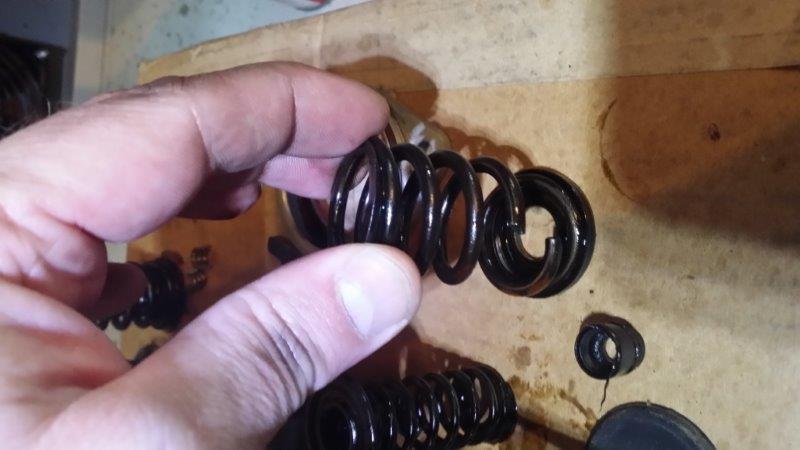

      I was surprised to find a broken outer spring on the #1 exhaust valve. I have no idea how long I had driven with that situation! I don't recall ever noticing anything out of whack...I guess it demonstrates that the engine will run with only the inner spring lol!:D
Name:	broken spring.jpg
