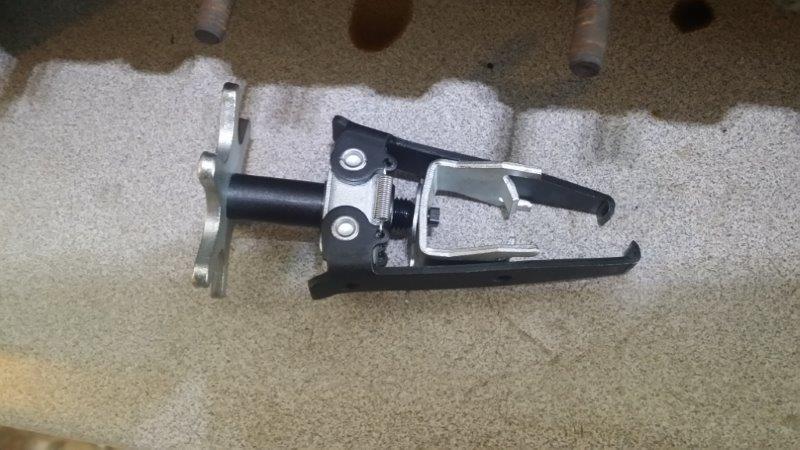

    Here's the Harbor Freight tool:
Name:	1 harbor freight valve spring tool.jpg

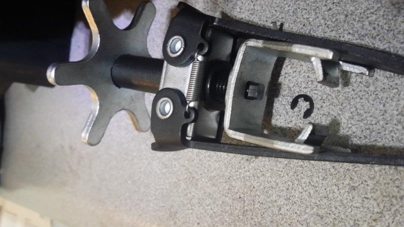

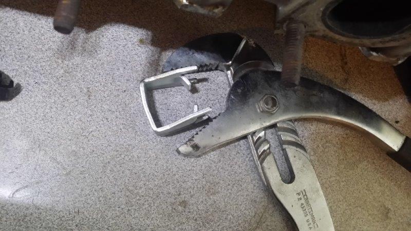

    I needed the adapter, so I removed the c-clip:
Name:	2 remove c clip.jpg
    then I used pliers to adjust the adapter...
Name:	3 adjust spring compressor adapter.jpg

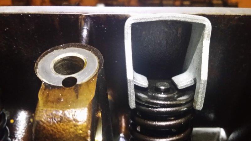

    ...to fit the spring retainers with clearance for the keepers:
Name:	4 adapter fit to spring retainer.jpg

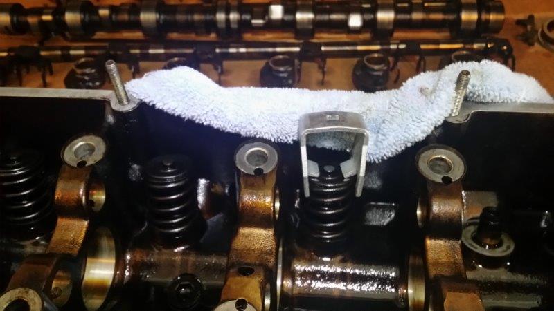

    Place a towel around the top, side, and bottom of the head where you'll be working:
Name:	5 place towel around head.jpg

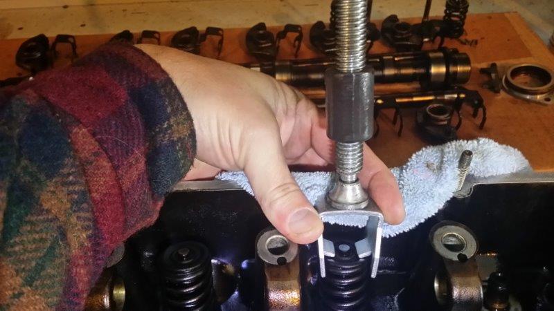

    Place the adjusted adapter on the valve spring retainer:
Name:	6 place adapter on spring retainer.jpg

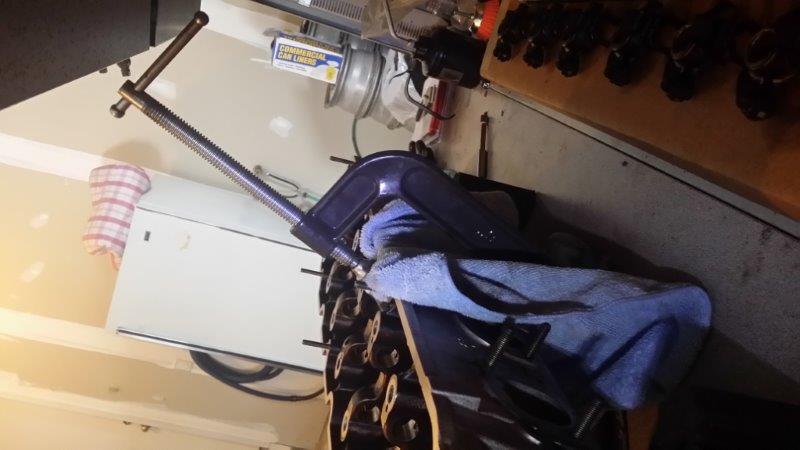

    the next step is to take your 6" c-clamp and place the fixed end over the valve (on the bottom), making sure the towel is between the tool and the head in all places:
Name:	7 6 inch c clamp over top and bottom.jpg

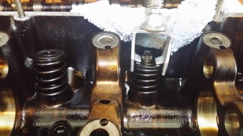

    hold the clamp assembly in-line with valve stem/spring assembly as you compress the spring. the adapter will stay on top of the spring due to it's retaining tabs:
Name:	8 keep clamp in line with valve and compress spring.jpg

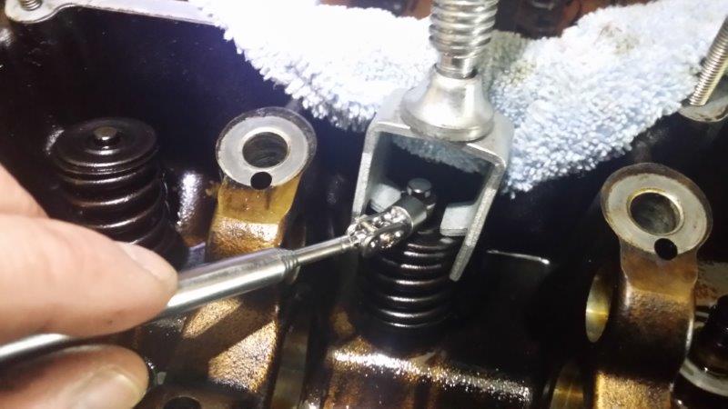

    continue until the retainer clears the keepers:
Name:	9 compressed spring.jpg
    Use a magnet tool to remove the keepers:
Name:	10 use magnet tool to remove retainers.jpg
    I hope this helps others. It worked really well for me. This may work on other heads, but the M20 is 175mm (just over 6" tall) with interference valves, so the valves are not so recessed into the head that the flat end of the clamp can't reach them. The towel is important since it's very easy to scratch the aluminum head.

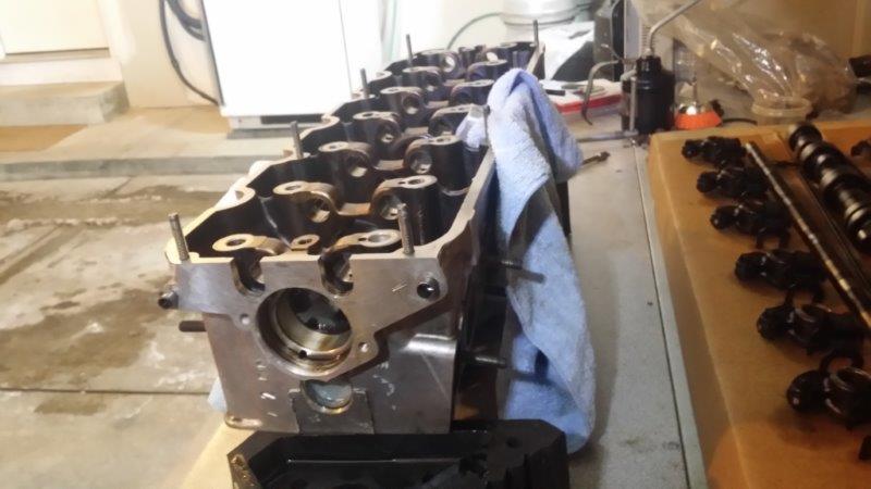

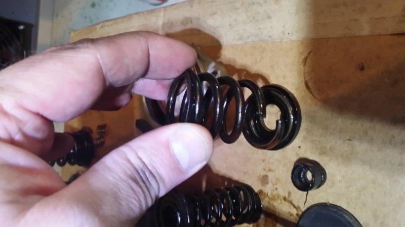

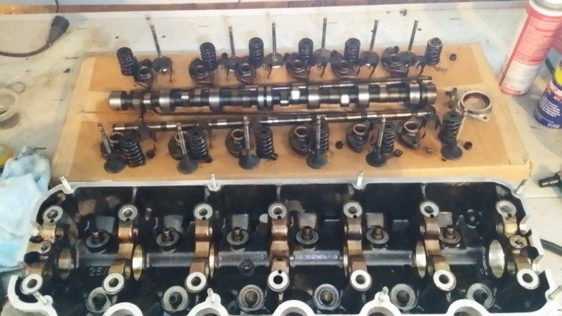

      And here's what you end up with:
Name:	everything removed.jpg
      I was surprised to find a broken outer spring on the #1 exhaust valve. I have no idea how long I had driven with that situation! I don't recall ever noticing anything out of whack...I guess it demonstrates that the engine will run with only the inner spring lol!:D
Name:	broken spring.jpg
