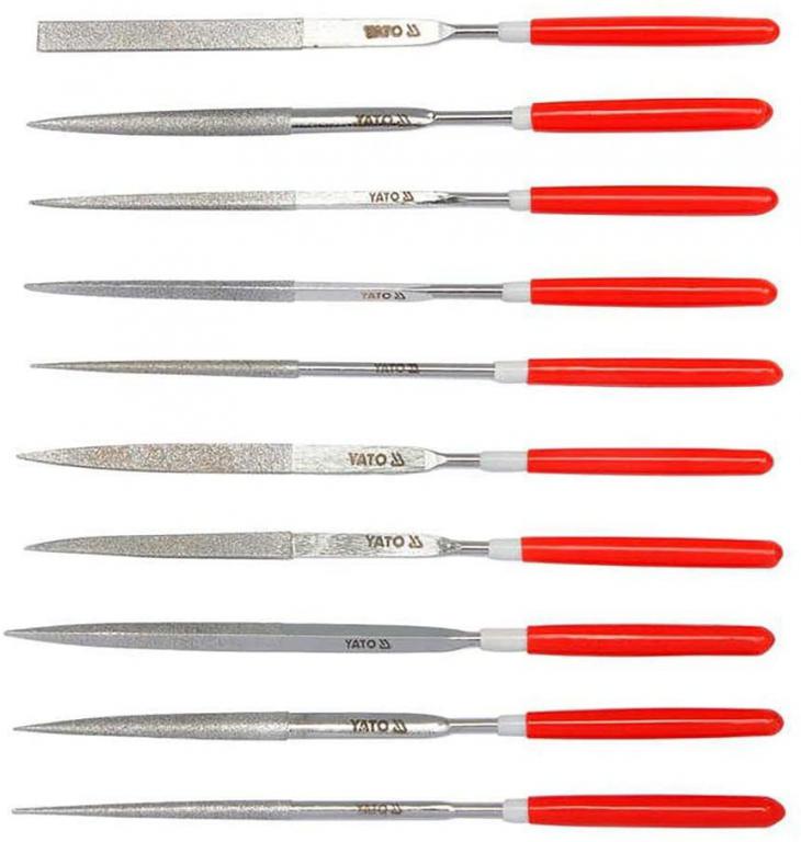

                  Most likely you guys would never need to replace those u-joints, they are sturdy and 95% of any play is due to that small plastic bushing or the flex disc.
                  If you have the shaft version, where the flex disc is riveted in, you can grind them off (i did that on my OE shaft), the used shaft i picked up came with the bolts and nuts. The manual does not indicate, if those bolts, nuts (self locking but non nylon) and washers need to be replaced or not, but i replaced them, since removing and installing that steering shaft is always a freaking headache for me.
                  Do not worry about rounding/grinding the female teeth on the ends of the shaft. The whole shaft is made from cast aluminium and is super soft, both the rack male teeth and the steering column teeth are steel, you can pick up a jewellers file kit for €10 or so on Amazon and file those soft teeth back to nice and sharp. This is what i picked up and two of those files fit perfectly to fix any issues:
