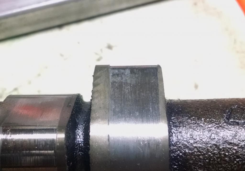

                              My 62k mile M20B27 engine has wear on every cam lobe, and one cam lobe is totally shot. The rockers are also scored, and the rocker shaft is grooved where the rockers pivot. I have a 150k mile B27 head with a perfect cam, it almost looks new. While there are many variables that can contribute to extreme wear, I believe this issue to be caused by an oil not suited for the job. I will be running a diesel oil or using a zinc additive after I rebuild the head.
