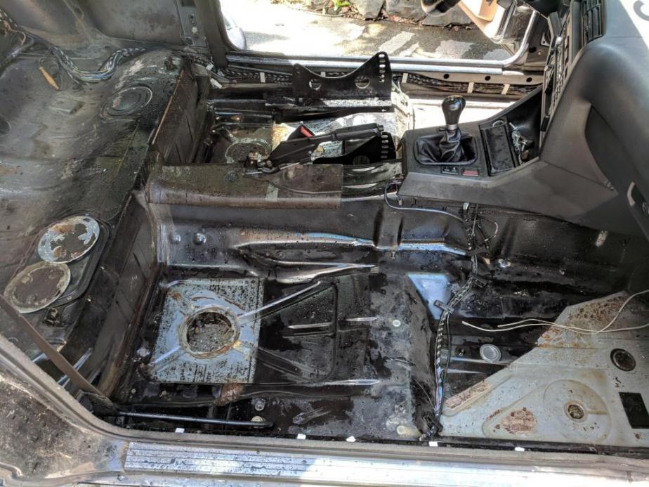

    Cleaning up the interior and almost have all of the old sound deadening removed. Just one quarter sized rust hole on the passenger side so thankfully nothing major! Is POR15 still the go-to coating for resealing floors these days? Lastly, how do I go about getting the big floor plugs back in properly? Can I coat both the floor and the plugs and then just pop them back in, or is some sealant between the two necessary? Thanks!

    Picture for reference:

          I think people use POR15 in a lot of cases where they shouldn't. POR15 is a rust encapsulator, and is designed to be used on rusty surfaces. From what I hear, it actually doesn't work well on clean and pristine surfaces, and sometimes will peel off. I've also heard that it is very difficult to remove if, for whatever reason, you want it gone later on. It's not a one size fits all product, rather, it's a product for a specific situation.
          I would repair the rust hole with new metal, treat any surface rust with naval jelly (Loctite makes some), and then prep it and prime/paint over it normally.

                    As to the plug, I'd seal it with seam sealer, like the factory did.
                          Why por15? It's ok when you are trying to seal the rust but sealing the rust it's not the ideal route if rust can be removed. I would just wirebrush any surface rust and used the epoxy primer and paint to treat the exposed metal.
                          Also why everyone go as far as removing factory body plugs and OEM deadening material? You will never do it as good as OEM, no matter what yo do. If there is no rust (like in your pic), let it be. Not only it will be OEM original but will last another 30 years.
                          I had two rust holes in my floor, one in the passenger front side (exhaust heat shield stud) and one on the passenger side of the middle console. I cut, welded 1.5" sheet metal patch and primed/seam sealed/primed/painted it. Console side rust repair was a little more complicated since there is a transmission mounting rail/panel welded from the under the car. No way to access the cavity to treat welded patch from under the car. I elected just to cut the rust out in the shape of rubber firewall/floor plug, treat edges with epoxy primer/paint and plug the hole with the rubber plug. You can find all kinds of plugs that are about the size of the rust spot.
                          My jeep has rubber plugs all over the floor by design with no issues of any kind. They make hosing down the floor very easy job.I think it is obviously much better approach than welding patch and not be able to treat the weld
