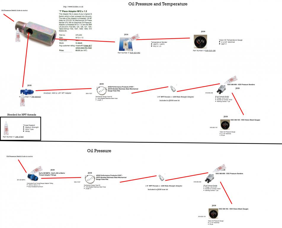

                            • Panici
                              • Dec 2009
                              • 2413
                              #59
                              Not sure if this helps.
                              This is my plan for pressure and temperature sensors. I have all the parts, but haven't had a chance to put them in.
                              Sorry for the multiple/large pictures. I had trouble with hosting and uploading making the text unreadable.
