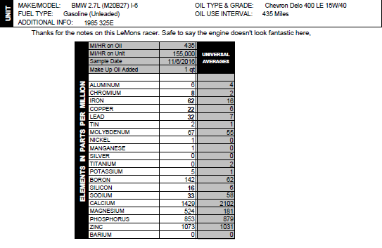

                            #73
                            You mean you want empirical evidence for claims made on the internet??
                            E30 guys are way too cheap to use Blackstone haha.
                            I had a couple of kits from before I had my E30, and used them - it was the Canadian equivalent of Blackstone. These were results I got on test back in 2013. I'm hoping to do one after my next change. Just haven't had the extra money to be consistent with them.
                            I'd posted this to BF. This was with Castrol Edge 5w50, BTW
                            KM on car: 285816 (Approx 171500 miles)
                            KM Since change 15930
                            Iron 13, Cr 1, Mo 79, Al 5, Cu 5, Pb 11, Sn 1, Ti 0, Ni 0, Ag 0, Si 7, Na 31 (they flagged this as either coolant entry, or possible additive in oil - Glycol was negative), K 2, Zn 1254, Mg 1449, P 952, Ba 0, B 14, Ca 710, Mn 0, V 0
                            Soot UFM# 0, Sulf UFM# 25, Oxid UFM# 19, Nitr UFM# 15, Visc cST @ 100 C 16.43. Antifreeze NEG, % Fuel Dilution <1.0, Water NEG
                            Makeup oil 1.75L (there is a small leak) - Interestingly, I've gone almost 8K KM and haven't added oil yet. Last oil change, I put the first 0.75 L in at 6800 KM.

                                #75
                                Um... How else is one to tell how prepared the replacement (baffled) M20B25 engine needs to be when racing a junkyard eta?
