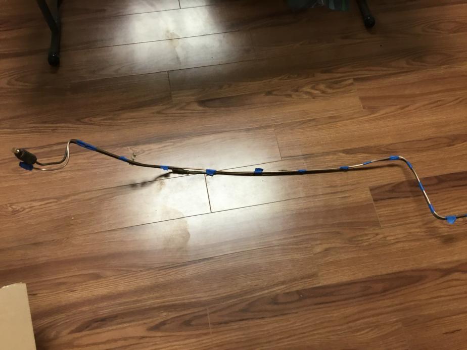

      Classic Tube sells complete sets. I fabricated a new set for my car using copper-nickel, which is much easier to flare and bend. The one long line that runs from front to back up above the differential is very difficult to bend.
      • cory58
        • 1021
        Replaced mine last winter. Definitely recommend CuNiFer tubing. Very easy to bend. I don't know of anyone who makes pre-bent kits, so you will be making your own. Sunnyledge is correct - the line running front to back, around the fuel tank and into the distribution block above the rear subframe is difficult to bend. I used the old line as a guide and still had to do a lot of hand bending. The two lines running out of the distribution block are also a PITA. I bought "Ultrabend" CuNiFer tubing and fittings from SUR&R (made in USA).

            A tubing bender is useful for some bends. But not for all. With copper nickel you can use various round objects to help form a bend. For some of the tighter bend I used a piece of pipe or even a socket (i.e. from socket wrench set) as a form to bend the tubing around. As Cory58 said using the old line to get the rough configuration is helpful. The final molding can be done as you press the tubing into the various brackets/clips.
