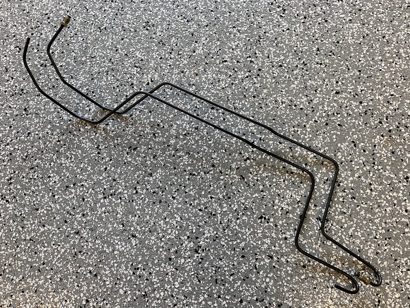

          Todays project is one I have been putting off for awhile but had to be done. I wanted to throw out the old brake lines but I could not do that until I had replicated them in new PVC coated steel brake lines. I went with the Poly Armor brand as it is identical in every way to what was originally used in our cars, color and all.
          All of the old lines were perfectly find from a function standpoint they just had bumps, scratches, scrapes, and corrosion on them being 28 years old and all. The flare nuts also of course looked like crap.
          Making new lines means being able to install replated flare nuts... so here we go.
          There are 5 lines total that run between the ABS pump and the brake master cylinder area, one of them runs around the firewall to the right front caliper, another to the left front caliper, and yet another to the proportioning valve for the rear brakes.
          I separated the lines from the plastic spacer/holders and proceeded one at a time to carefully bend new straight brake line to match them perfectly.
          The lines with the fresh flare nuts of course are the ones I made.
          The hardest line of them all is the one that runs from the ABS pump to the right front caliper just because of how many complex bends it has and how damn long it is makes it difficult to hold and articulate while bending. All said and done I managed to faithfully reproduce each line the very first time with the exception of the super long one which I flared before installing a flare nut.... fuck... lol...

            Nicely done. Those complex lines are a royal pain to do at all, let alone reproducing the OEM line...
            Not sure if you've ever come across these brake line fittings (or perhaps you have but decided not to use); they appear identical to the OEM fittings from what I recall after purchasing a few years back. Cohline brand.
