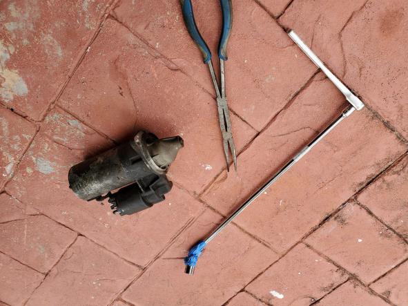

        Quick follow up to this.
        I have ordered a reman Starter and replaced it and fixed the problem. Car starts fine now.
        For those planning to replace a Starter, prepare yourself with lots of patience to avoid frustration. This is a real painful project. I've researched a lot and most people complain about it. Some removed the Intake, some the Transmission and some say it was not needed.
        I removed the Air Filter Box and did not remove the Intake. However in my case - Auto Transmission - I was not really able to reach the eTorx Bolts. Tried with multiple extensions, u-joints, etc. and not enough space coming from behind the Trans or from the front. The firewall and the Trans Dipstick make it impossible.
        So, for the lower eTorx bolt, I jammed a rubber piece between the bolt and the Trans Hosing and loosened the nut from the front. I stuck a large plier to hold the upper bolt while loosening the nut and counted on my son's patience to reach it.
        Tightening was somewhat the same, but I was not able to apply a high torque to the nuts and hope they stay in place.
        Pix of the tools used to do it. Painter's tape used to reduce the u-joint flexibility, so we could go through the hoses/wires and keep the Socket aimed right. What a pain.
