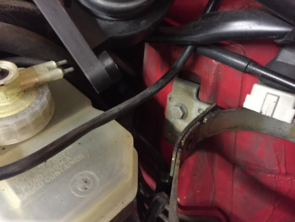

            Front sway bar – is this common for the brackets to snap loose this way?

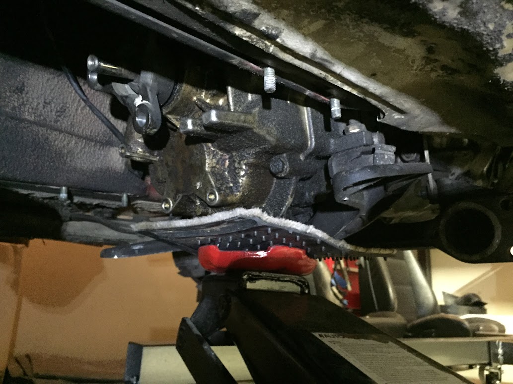

            This brace supports the transmission and needs to be removed before lifting. I removed all four bolts connecting the brace to the body, but had the jack in position under the brace when doing so, so it kept brace under the jack until the engine was far enough forward that it didn’t need support. Its easy to figure out when under the car. The transmission mounts connect to the two holes in the center. Going to upgrade mine – one was ripped halfway through and I ripped it the rest of the way with almost no effort.
            Jack under the transmission for support, on the brace here.. Don’t want it slamming into the ground when the engine goes up. Cut up some floormats from my wife’s old car to avoid metal on metal contact – worked great

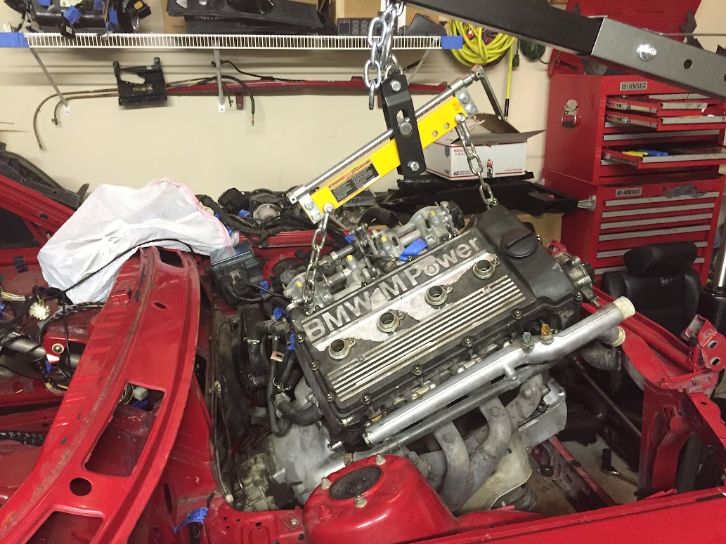

            Lifted a little to free the engine mounts
            Little more and they’re free.
            I kept repositioning the jack so the trans didn’t slide off. This was a lot of lift and reposition, lift and reposition. I took my time because mistakes here are $$$, also I was by myself, so that didn’t make it easier.
            Liiift
            Jack sliding forward, slid into the legs of the hoist before I lifted far enough that the trans didn’t need it anymore
            A Balance bar is DEFINITELY needed here, also I should have had the crank handle facing toward the back of the car, the angle got so steep I had to take the crank off to turn the bolt because the handle was hitting the arm of the lift.

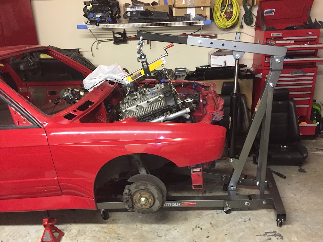

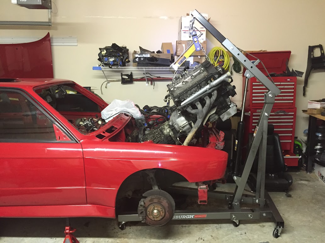

            Just a few pics of the extraction.
            Bumped into the front here, but it didn’t do any damage
            Caught the insulation a bit on the way out, this is where another set of hands helps – but it did no damage. Putting it back in I’ll be much more surgical.
            OUT!

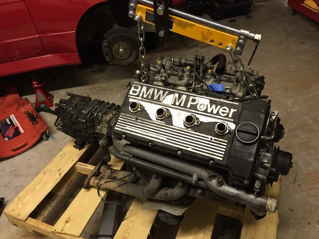

            Engine shots

                  I put the engine on a shipping pallet I got for free from Lowes – shipping pallets are one of those things I have never seen for sale, but see everywhere – so I just asked if I could have one they were throwing away.
