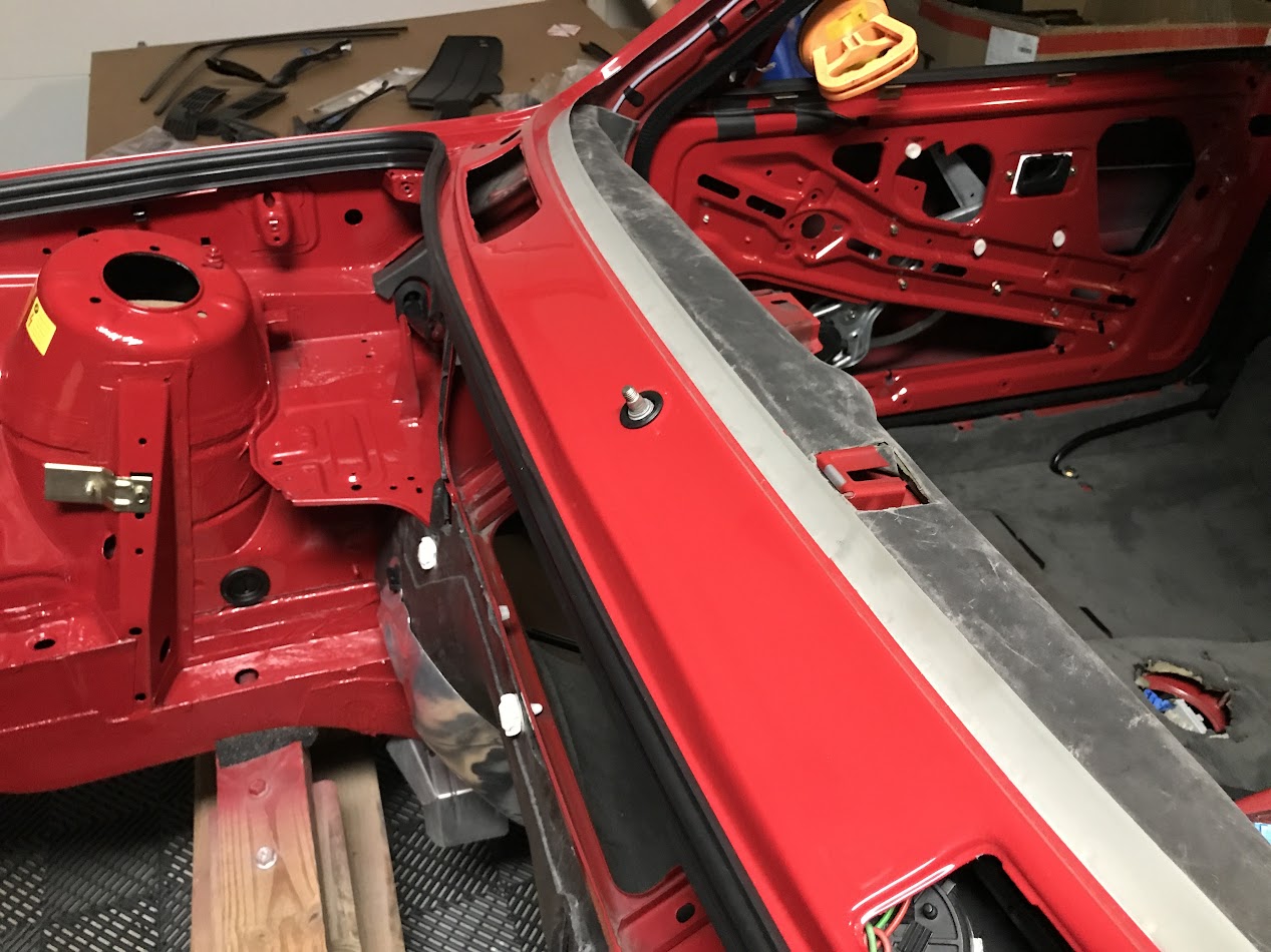

                  Rear deck
                  Remember that little guy curled up in the engine bay from page 14?
                  if you have old, uncleaned seat belts, might not want to watch this next part...
                  this is from pressure washing one belt, and just the stuff that didnt go down into the floor or fly off to the sides. Thats a lot of dead skin cells...

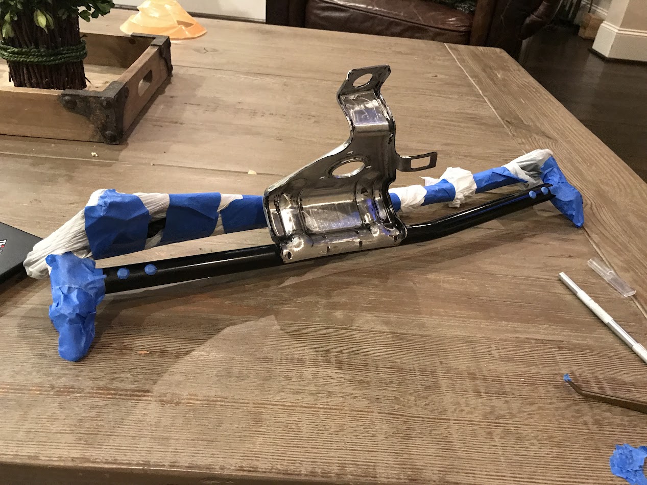

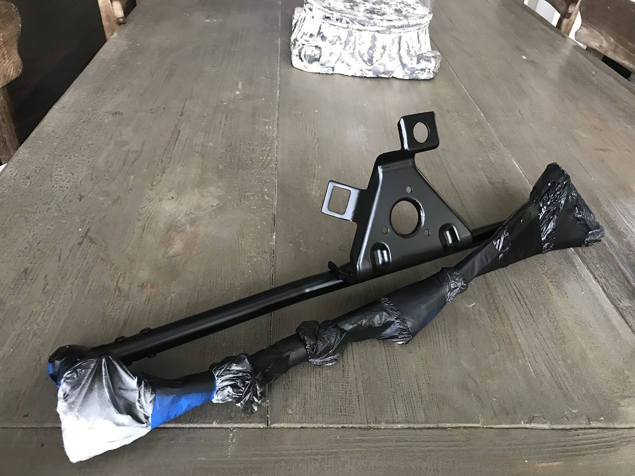

                  Oh and that spot spray job i did on the rusted portion of the wiper linkage 3 years ago wasnt up to par. The standards have come up a bit since then i would say...
                  The inside of my reconditioned wiper motor had some rust on the inside. 24 hours in Vap-o-Rust and...
                  Then sprayed with a rust prevention black enamel paint.
                  And reassembled with newly plated fasteners
                  Leaving the three bolts that hold the motor on loose for the install helps to maneuver the linkage into place. It was a lot easier not having to navigate around the heater box too.
                  Screws holding on motor still loose, cover is easy to get on
                  I'm going to replace the yellow plated flat nuts on the wiper arm nubs with standard silver - thats what was on the car before and i think its factory correct.
