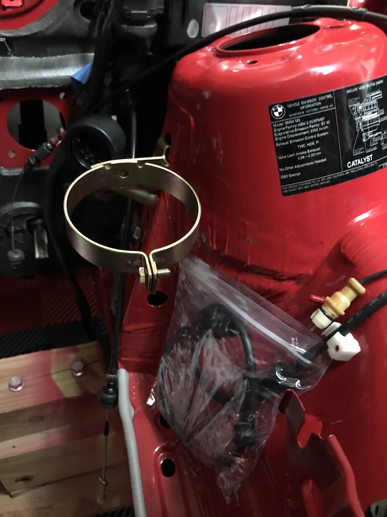

          Could I ask a cheeky favour the next time you are out in the garage working on your car ?
          I'm missing the parts that hold the front bumper indicators ( the ones above the spot lights ) and they are unavailable to buy. I also have my bumper away from home in long term storage during the restoration, so not able to try and mock anything up.
          The ETK shows what I guess is a stud on a square plate which slots into the bumper and which the indicator in mounted on 2 rubber mounts.
          Next time you are working on the bumper, is it possible you could take measurements of the part and post them here so I can fab something up ?

            Sure. Happy to. I'm actually missing one (P.O. had it held in with a regular bolt and stack of washers. My plan was to check local pull-a-part yards on regular E30s as i believe some of them use this part as well. Funny enough - actually have a picture of the part on my desktop...
            I have the measurements somewhere too. Next time I'm out there I'll grab my calipers. Also, if you do make something - PM me as i might be interested in one.
                Many thanks. Seems the part is M3 specific and looking at the ETK for other E30s ( I just checked a couple ) they use just an ordinary screw to attach the body of the indicator.
                I will post up if I find anything or fab something up. I'm cleaning up boxes of bits and thought simply doing the indicators would be a 2 min job, but no. Some previous owner bodged something up, and even the reflector lens inside one of them was mangled, both bits being unavailable along with complete units.
                  I had the same problem with my bumper. I went to the local hardware store and found metric "elevator bolts" as they are called. They are a flat round head. I bought some and trimmed the sides of the head down to a squared-off edge and they slid right in the bumper.
                  You'll also need to come up with some sort of rubber stand-offs if you don't have those as well.
                      I do have the rubber gaskets. those are still available. I may have to mock something up, but I would much prefer the original thing. I'll have to look around a bit.
                          Let me know if you find anything. I'd sure like to have originals too. According to RealOEM it looks like they were an M3 only part.
                          http://www.realoem.com/bmw/enUS/part...758&series=E30

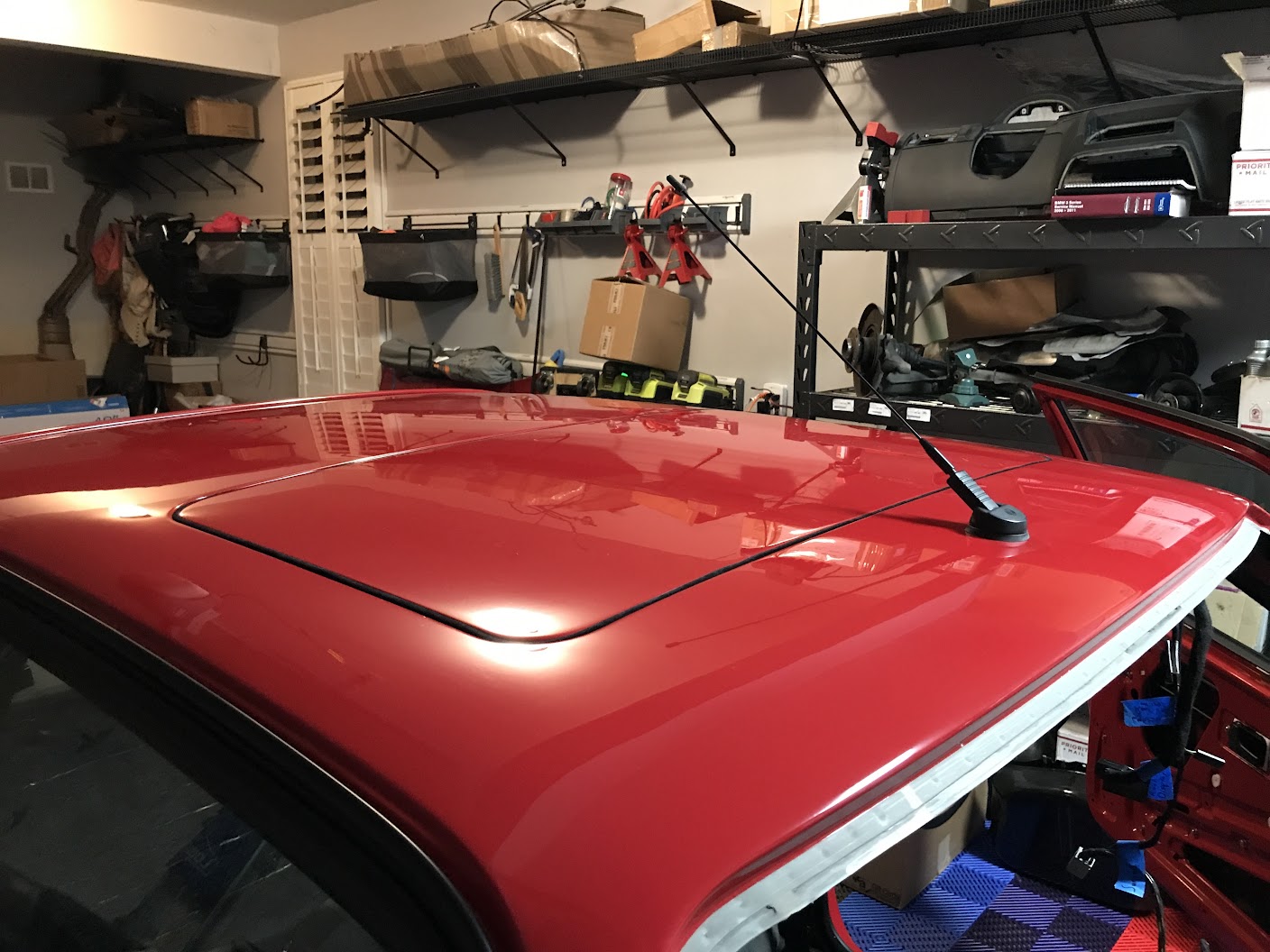

                              Hey guys,
                              Been a while, so here are some new updates. Some little, some big.
                              Windshield wiper linkage in
                              Sunroof in – will have to adjust the upholstery panel when I get the electrics powered up
