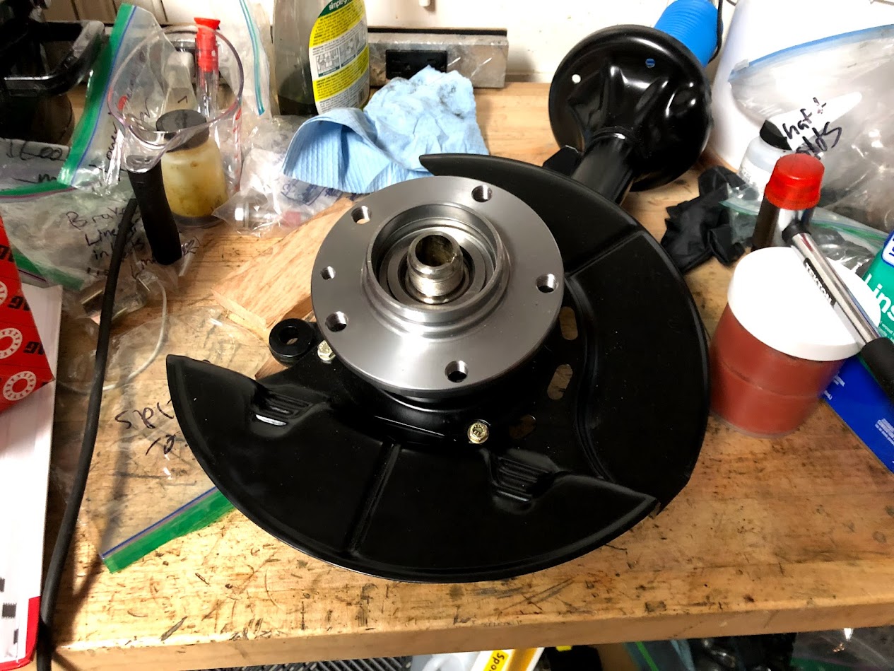

        FRONT SUSPENSION
        New ball joints in front control arm
        M3 ABS ring gear (left, vs standard E30 on Right) zinc’d and installed on new front hubs
        New shocks, freshly powder coated strut housings, some oil for lightly lubricating the inside (Korman said a light coating inside helps with anti-rust, but it isnt required like with factory ones)
        New dust cover for the back of the bearing. Tapped on easily with a runner mallet and one of the press fittings from the bearing kit.
        Time to reconnect the lower knuckle.I had them powder coated separately, left the facing sides bare but they got blasted clean.
        Front brake backing plate
        Time for these guys
        They went on really easily. No need for a special tool. Literally pressed them on with my hand, then took a block of wood and rubber mallet to tap them the rest of the way down. Only had to get them to where the nut will thread, then you can tighen down the nut to get it all the way on. I’m waiting to torque the nuts down until the car is on its wheels.

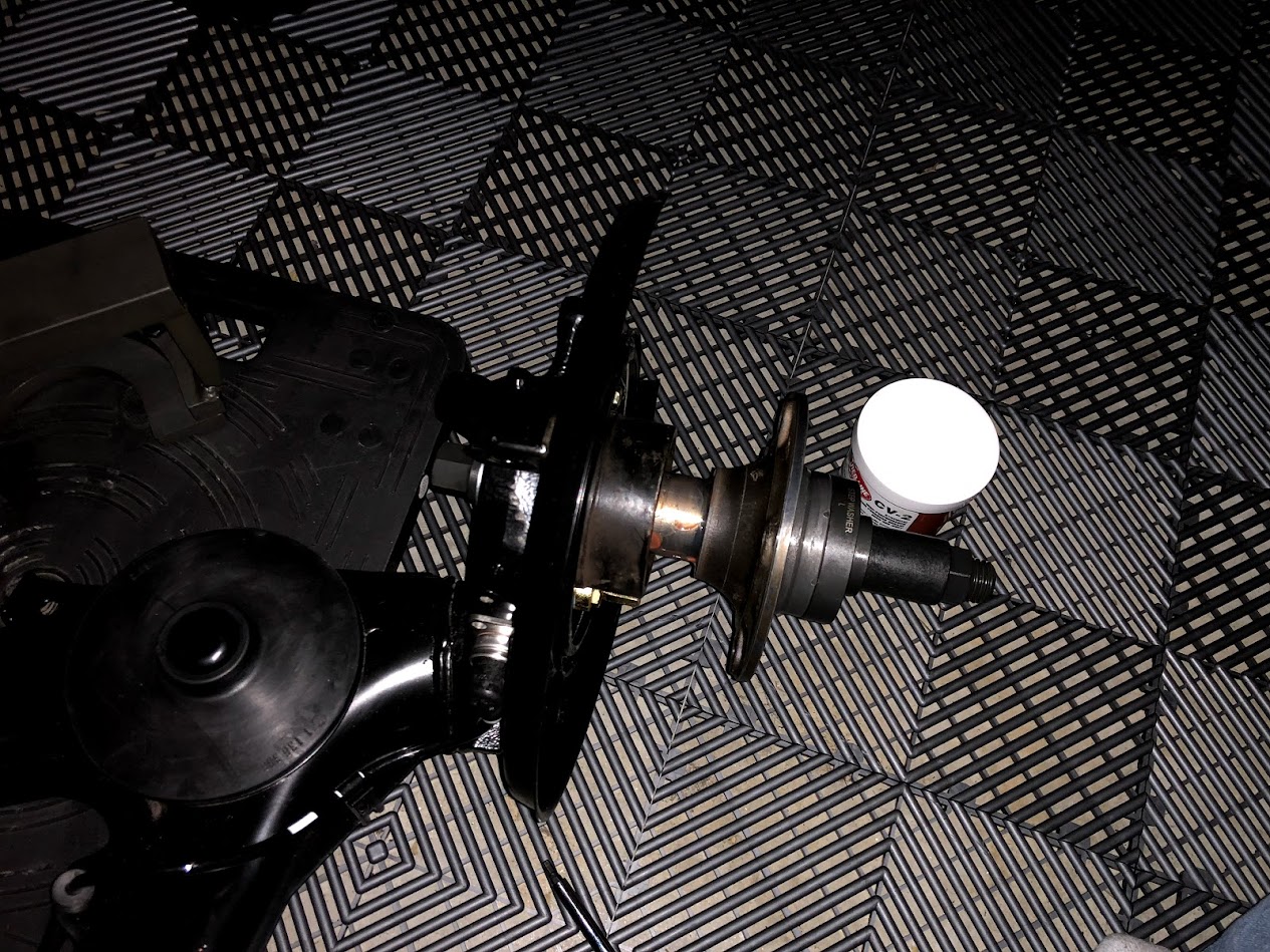

        REAR SUSPENSION
        Rear subframe mounts
        Pressed in by hand. No tools needed. Just Teflon grease.

        ABS sensors - this got much more complicated than it should have. My avatar says “DO NOT OVERTIGHTEN” for a reason….
        So i was putting them on, easy enough, put on the replated bolts, looking good, tighten, tighten, tighten, SNAP.. Bolt brakes off in the rear trailing arm. Great. So, out comes the drill. Drill Drill Drill Drilll. Then….
        I had been meaning to buy a tap and die kit anyways…
        Cleaned out and tapped
        Victory.
        Cleaned out the hubs. Cleaned up nicely.
        Pressing on with the bearing tool.

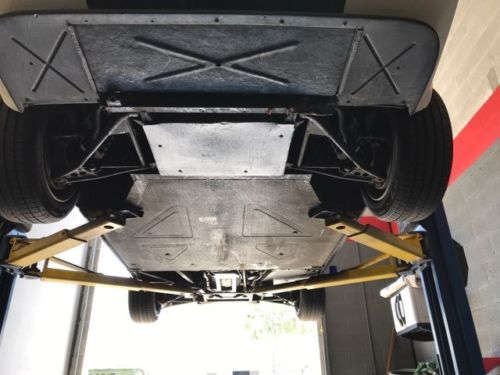

              Awesome update. It’s coming together beautifully. By the way did you not restore the underside of the car?

                4 Years in... Rebuilding an E30 M3. I finished college faster...
                Thanks and good question. The underside of the car was in great shape aside from a little dirt here and there. I was going to have it sprayed black, but my body shop pointed out that they see a lot of restorations where black undercarriage spray is used to hide issues like rust, damage, etc. So I left it original to show that there aren’t any issues with the structure of the car, and pressure washed it as much as I could without cutting into the underbody material. Parts of this restoration have been a trade off between originality and perfection - on the underbody I went with originality. I may go after the underside with a steam cleaner before it’s done
                I see there are a couple broken links and pics out of order. I’ll fix it later. Tried to edit from Tapatalk, but the update is so big that trying to edit it crashes the app.
                    Yeah steam cleaning sounds good but I recommend a clear rust proofing coat. This way you’ll be able to show the originality of the car.

                      Originally posted by bradnic
                      The shame must be unbearable
                      Good thought. Not that this car will ever see salt, or rain, or anything that could cause rust. The camera flash also makes the underside look way dirtier than it is.
                      I'm actually thinking about fabbing up a full underbody shield a-la the M1 to keep everything clean. I'd have to have a way for the exhaust and transmission to vent since its a front-engined car, but i could keep things from getting dirty and improve the aerodynamics. Maybe i could use some roles of pre-preg carbon fiber...ok lets get the car done first before we start down that rabbit hole.
                          I don’t think you need a full underbody shield but that’s up to you. It looks great the way that it is. It looks amazing. Keep up the good work.
