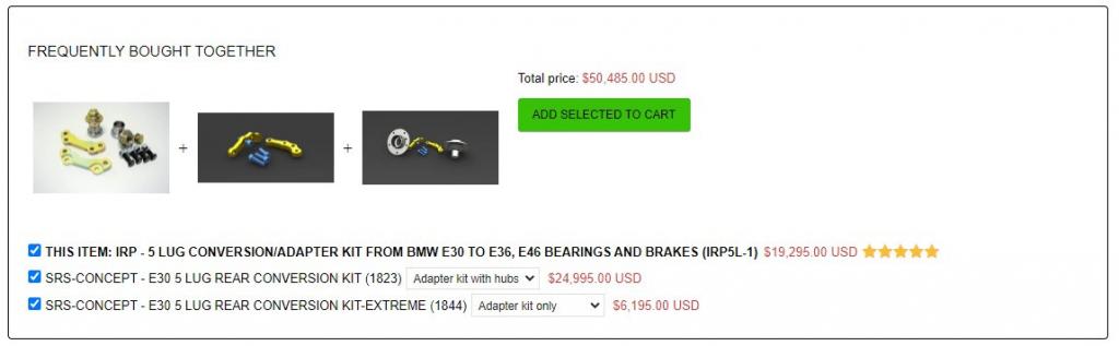

                  Probably bought this bundle:
                  https://www.drifthq.com/products/irp...30179147743279
                  Their currency conversion is um... hopeful?
                  Click image for larger version  Name:	Screenshot 2022-02-01 155843.jpg Views:	11 Size:	33.4 KB ID:	10044215
                  Well I wish them good luck with their sales, I guess.

                    Their contact says they are in FL. Could ask if anyone has made a purchase if you feel unsafe? Or pay with paypal.
