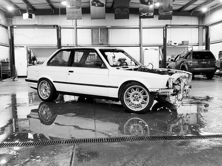

                      My setup:
                      e30 m3 5-lug with H&R OE Sports and B8s
                      Wheels: e28 m5 RZ 16x7.5 et20, Powder coated porsche silver lip with Nogaro center (cosmic gray)
                      Tires 215/25/r16
                      Alex 88 m5 | 91 318is | 19 Subaru Ascent
