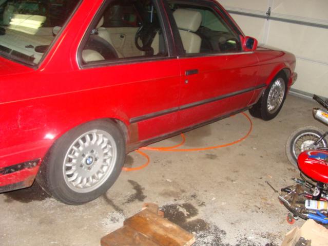

            Got bottlecaps on all 4 corners now, and it rides alot better than it did with 16's.. looks kinda cool too cause the wheel/tire assemblies are stuck farther out with the e36 offset
