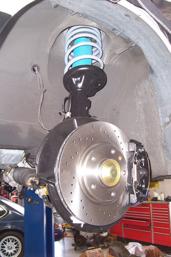

About the style 5 (E39 or, in my case, E31): The front wheels are ET20, which should fit, but there was minor interference with the calipers, which we shaved a bit with a dremel, but the anti-rattle clips won't play with the wheels. Some guys on s14.net say they wait until the pads are worn halfway then the clips will work. Others use a 5mm spacer, but that pokes the wheel too much leading to fender interference (solve one problem and cause another). I just ordered the new 2mm spacers from ECS tuning. [EDIT: RECEIVED 2MM SPACERS. NOT THICK ENOUGH!] That should be just enough to get the anti-rattle clips on and not cause other problems. The E31 rear wheels are ET26, and apart from slight contact up inside the fender on full compression, they fit just fine.
Your first picture is that with the 2mm spacer? and how much did you take off the caliper to fit the wheel on?Comment
I just ordered the 2mm spacers, so I don't have 'em yet. Meanwhile, I've got no anti-rattle clips in front and the shit is noisy, rattling and clanking down the street. I don't recall exactly how much was taken off the caliper, but it was very little.Comment
Thanks. Let me know if those spacers help.Comment
