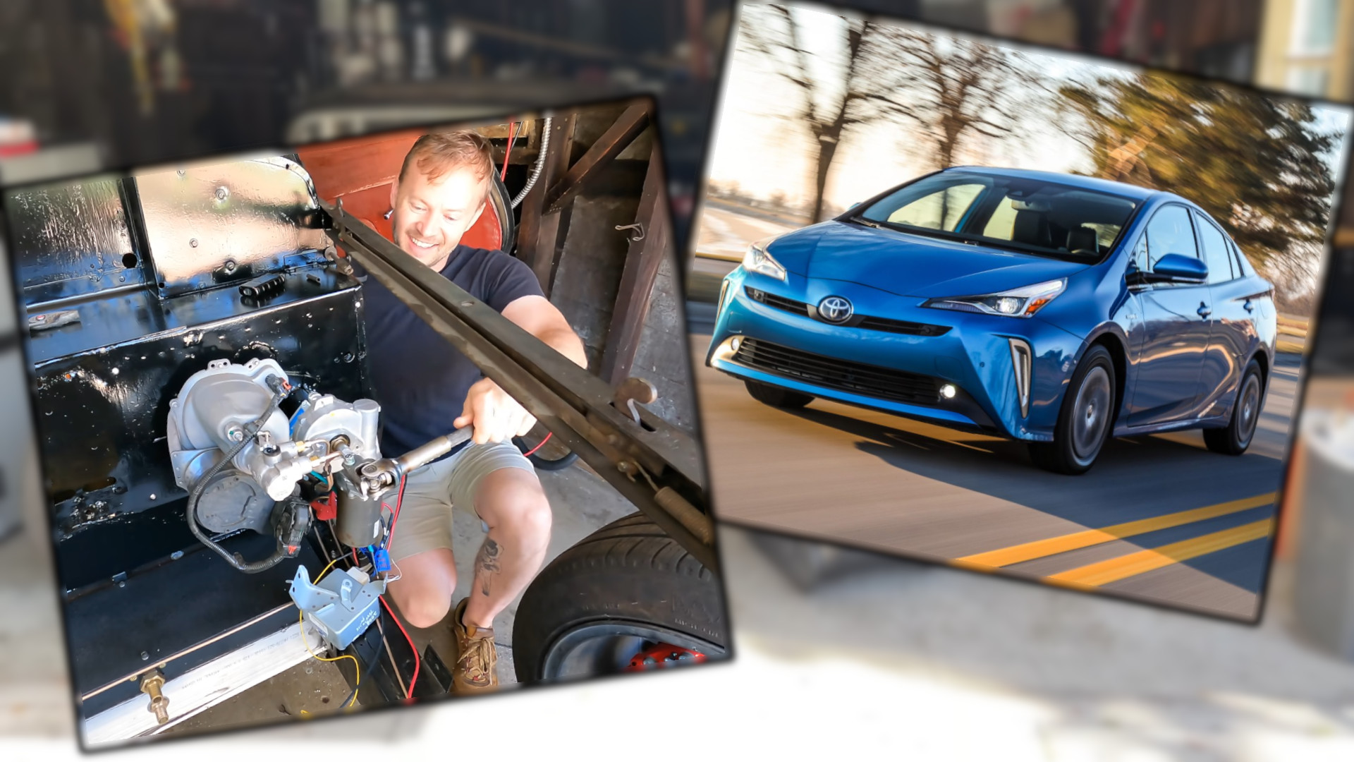

            I am not sure why Porsche people don't like it. Maybe the 991 electric unit provides too much assist? Or its completely wireless?
            I have a prius PS unit but I have not had the time to set it up in my e30 yet. With the unit powered off, it's as if nothing is there, you get a 1:1 feel. Applying power the unit provides steering assist. from what I read, the box provides a flat rate of assist. It's been a minute since I read up on this, but I believe someone had a unit that could adjust the amount of assist with a dial. I want to get rid the need for power steering fluid altogether.
            Thanks to the proliferation of electric power steering in modern cars, hot rodders now have power steering options that increase fuel economy and power!
            https://www.thedrive.com/news/41845/...ny-project-car
