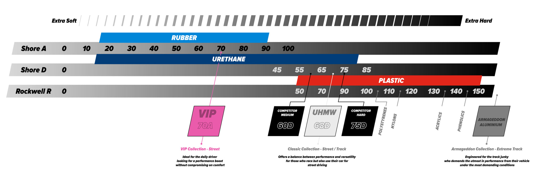

      Explore our tailored collections to find the perfect engine mount for your vehicle, enhancing both performance and comfort. Whether you’re cruising the city streets or tearing up the track, our three specialized collections have you covered. VIP Collection - Street: Ideal for the daily driver looking for a performance
      I see in your build thread you used the akg brand for this application (I'll talking about the riser subframe bushings). From what I've read about UHMW having something of a constant lubrication feature and it being just below the 75D of the AKG, (68D), one would think it would be the better material? Did you use lubrication? If so what did you use?
