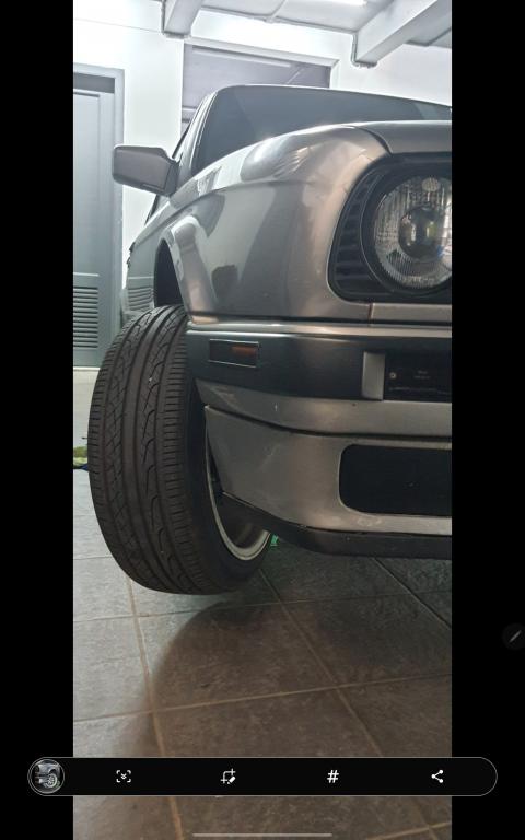

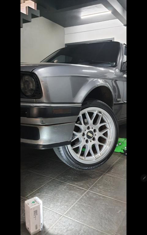

    The yellow tag e46 rack on my e30 made the steering radius way tighter. I have more steering angle and could probably do circles on a 2 lane road at the locks. Have a picture of how much steering angle you have in both directions?
    Did you get it aligned? Having the toe out will cause some level of bump steer feel. I have a more "darty" feel with the e46 rack with the quicker steering ratio which is normal but I don't have bump steer or any unstable feeling. I can let go of the wheel down a bumpy road and feel confident the car will continue going in the direction it's aimed.

      Lemme take a photo
      I had it alligned twice after installation and it did nothing to improve the bump steer and the radius. Quite annoying to be honest

        • 82eye
          • Jan 2009
          • 2069
          angle doesn't look too bad. is the coupler modded right and not binding ?

            Nope. I did check it again and everything worked fine. Would bigger diameter wheel diameter affect turning radius? I have 17x8s with 205/40/17 tyres on

              oh. 17s are big but shouldn't make a difference if the tire size and offset match up and work. they'd have to be contacting something. doesn't look to me like they are, and i'm sure you'd know it driving.

                Thats what I thought. The only thing that makes contact is the tyres and plastic inner guards. When i jacked up the car and turn the wheel from lock to lock, I can feelnthat the steering rack is moving freely and stop at what appears to be at full extension

                    That looks similar to my steering angle. Wheels wont matter, I'm on 17x9s with 245 tires up front. Also curious on where you put the rack spacers (top or bottom) and how low are you? Thatll play into bump steer but none of that changes your steering angle.
