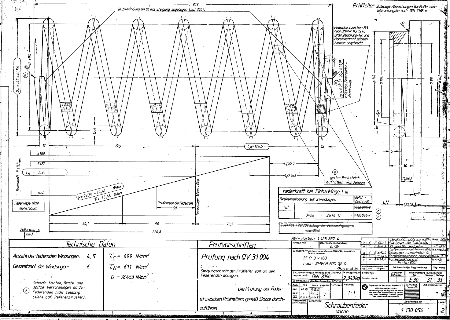

    Attached is the blueprint for the front sports springs I have that BMW Group Classic helpfully sent me, both as tribute and in case it'd help anybody else in the future. If I'm reading it correctly (I'm not 100% sure) the overall length/OAL is 150.1 + 126.5 +12 + 12 mm, i.e. 300.6mm, i.e. 11.834 inches. 313mm if you count the bits at the end, 12.322 inches. Unfortunately they didn't seem to be able to find the blueprints for the rear sports spring, so that's all I've got in terms of hard numbers.

    Click image for larger version  Name:	Screenshot 2024-02-08 at 14-14-05 Ganzseitiges Foto - e30 PN 1130054.pdf.png Views:	2 Size:	174.8 KB ID:	10114007​

    Oop, sorry for the double-post but the forums upload shrank the blueprint image beyond legibility for the front spring. Here it is in full resolution if anyone needs it (#31331130054).
